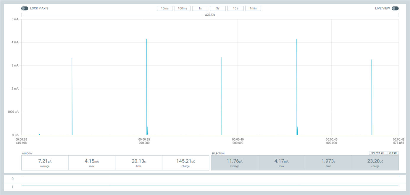

    Currently in the idle period we are observing a current spike of 4mA at every 4 seconds interval. What can be the cause of this current spikes?
    Do you configure any timers in your application?

  • Do you configure any timers in your application?
    We are using the k_timer module provided by the kernel in the application, but it is not configured for 4 seconds. Will this module contribute the power consumption in idle period?
    Other than this RTC is also enabled. But ticks and other interrupts are disabled, only the counter value is used.
    By timer I meant the calibration of the RC oscillator which is used by the timers. Can you try to change the calibration interval as suggested by my colleague Vidar here and see if correlates with the current plot?
