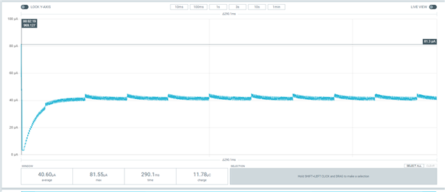

I am trying to build an application for a custom board developed with nrf5340 module in which power consumption is a major dimension which we focus.
Currently in the idle period the device is consuming arounf 48uA current.

    We had done a small testing by just running a simple application, without using any features. Here we were able to observe a current consumption around 8-7uA.
    Is it avg current or peak?
    This is the average current observed.

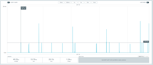

    Adding some Images of the current trace( The second Image is a zoomed image, After a peak the raising of current till 42uA).

    Do you have a Thread router? Maybe you could try the Thread:CLI sample to verify your custom board, it implements Sleep End Device type
    RTC peripheral is enabled without any tick, capture compare property. Only counter is used for keeping track of time.
    If you disable this feature, for example by commenting all code that use the RTC. What current do you get?
    What other peripherals are you using?
    What else do you have on the custom board? Does the nRF5340 communicate with any other device on the custom board is any serial connected?

  • Hi Jared,
    I have a Thread border router and I had done a test with the Thread CLI sample. With this sample also I got similar result . Power consumption was around 50uA. These are the steps I followed :
    1. Image was build with configuration files : "overlay-ci.conf and overlay-low_power.conf" and device tree overlay file : "low_power.overlay"
    2. Flashed the custom board, and provided the following details
      1. Thread PanID
      2. Thread Channel
      3. Thread Network Key.
      4. PollPeriod was set to 1000ms
      5. Mode was set to child
    3. To start the thread following commands were used
      1. "ot ifconfig up"
      2. "ot thread start"
    4. When device joined the Border Router, UART got disconnected and the power consumption was measured as 47uA
    Am I missing any steps in the test?
    50 µA in sleep? What else do you have on your custom board?
    Do you have a devkit you could try to repeat this on and see if you measure the same using the same measurement setup?
