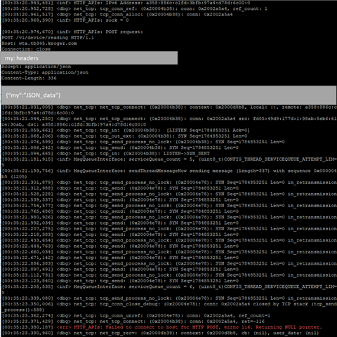

Persistent (-1) error in POSIX connect() function for TCP reconnection
I am doing HTTP POST's and GET's from my nRF52840-based device to a Java Spring Boot HTTP server running on a laptop via TCP. The device is communicating with a border router via OpenThread. The border router and my laptop are both on my local WAN (laptop's IP is 192.168.1.27). When the device boots up and the server is running, I can do POST's and GET's without issue. When I turn off the server to test the device's reconnection logic, I see the SYN message from the device trying to establish a connection with the server. The connect() function subsequently returns (-1). If I bring the server back up while the device is still making these SYN attempts, the connection is re-established and everything resumes properly.

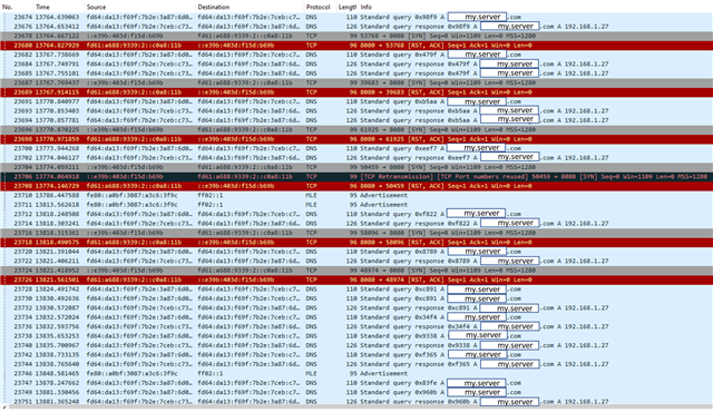

However, if I do not bring up the server after some time (usually a few minutes), the device stops sending SYN messages and only does DNS lookups of the server hostname. The connect() function still returns error (-1) but no longer actually tries to establish a connection. If I bring the server back up, the device never re-establishes connection with the server due to the lack of SYN messages.
What is going on with the device's TCP connection that causes it to stop SYN reconnection attempts?
OpenThread Wireshark traces:

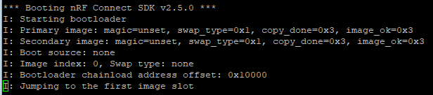

  • Which nRF Connect SDK version are you using? v2.3.0
    Is your project based on a sample? It is based on the TCP/TLS connections in the nrf/subsys/net/lib/azure_iot_hub nRF Connect library. I had my application working great with TLS and a nearly identical code structure. Then I scaled it back to TCP for various reasons.

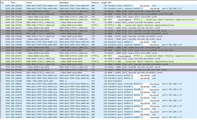

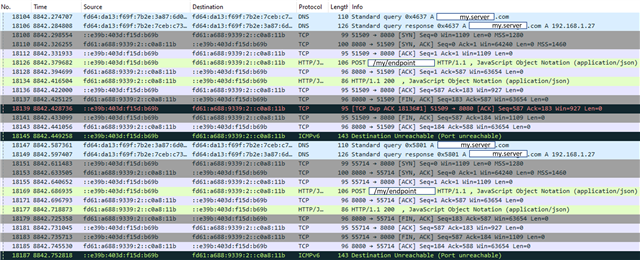

    I just observed an interesting transmission sequence that could help with troubleshooting. The device successfully sent a large number (~650) of locally stored messages to the server. In the middle of clearing this local message backlog, the device started to exhibit the behavior in my original post. This is interesting because the server never went offline and messages were sending successfully until the error was encountered abruptly. There were a few failed transmissions in the middle of the successful sends, but the those messages were always sent successfully on the first retry. Maybe I have a buffer that is filling or sockets that aren't being closed?
    ^See original post for code that generates this error message. This error occurs for each of the DNS lookups in the bottom-most blue block of Wireshark messages

    Per the documentation for connect(), the return value being -1 only indicates that an error has occurred. To find out which error which caused the call to fail, we need to know the value of errno after connect() has returned with an error. Make sure to save the value to another variable before doing any other function calls.
    My suggestion for how to do this:
    You need to include errno.h and change the variable which is printed in the LOG_ERR on line 100 to be errno instead of err.
    You can then find the relevant error code in zephyr/lib/libc/minimal/include/errno.h.
