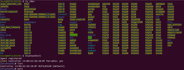

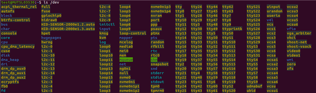

 I am using nrf5340 dk board for my application development.  I want to configure the nrfUSB port as bluetooth controller and serial port
case 1:
 when iam trying to flash the bluetooth/hci usb application,then nrf USB port acting as a bluetooth controller by showing it as extra bluetooth controller through bluetoothctl command and it is not showing as serial port when iam checking with ls /dev command
case 2:
when i am trying to do flash the smp server with usb_cdc enabled hci_usb application ,then  nrf USB port it is not showing as bluetooth controller,but the serial port is enabled where the new images can uploaded through mcumgr.
I need a mechanism such that nrf USB connector in nrf5340 dk board should acts as a bluetooth controller and also acts as a serial port to upload the new images through smp server (mcumgr)

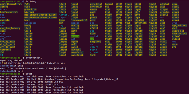

  •  I am not able to show another bluetooth controller in bluetoothctl after modifying it as you told.

    Build command used-
    test@MUTSL03530:~/ncs/v2.4.2/zephyr/samples/bluetooth/hci_usb1$ west build -b nrf5340dk_nrf5340_cpuapp --pristine -- -DOVERLAY_CONFIG=overlay-cdc.conf -DDTC_OVERLAY_FILE=usbchanged.overlay -DCONFIG_MCUBOOT_SIGNATURE_KEY_FILE=\"/home/test/ncs/v2.4.2/bootloader/mcuboot/root-rsa-2048.pem\"
