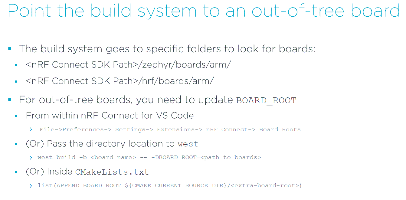

  • The short version of my issue is I had another copy of my device tree in a location where West could find it, but the one I was editing was not the correct one.
    This came from several attempts at getting this working while being pulled off onto a different project daily. I had the device tree that I was editing in the project root under boards/ but the one the West could find was a temporary version I put in the Zephyr boards/ directory. That is why my pullups were all set to up for the GPIOs and even the pin number were incorrect. None of the PWM changes I made were changes to the correct file. I found this after using Nordic's graphical tool for the device tree and noted that it was opening the copy I was not editing.
    This brought me back to the issue I hadn't solved, but had forgotten about. I want to use an out of tree board definition. The seminar showed a couple of different ways to do it in NCS:
    I've opted to use something that works for regular Zephyr by adding a few lines to my CMakeLists.txt file:
    # BOARD_ROOT and BOARD need to be defined before finding Zephyr so the definitions are available before compilation
    set(BOARD_ROOT ${CMAKE_CURRENT_SOURCE_DIR})
    set(BOARD smrtsw_v1_2)
    I inserted this before
    After that line is too late to define the BOARD_ROOT and BOARD.
    By including the BOARD I no longer need to define on the command line if just using West and the code is easier for me to keep in one repo and distribute to my coworkers.
    Now the device tree is at least referenced correctly, but I haven't gotten the code to run because there is an issue with the UART initialization. I had to include "zephyr,bt-uart = &uart0" in the chosen section of the device tree to allow it finish compiling, but I didn't need or have that before. I don't think my project needs the UART even for the RTT. Is that correct? Getting rid of all references to the UART in my device tree also does not make it happy. I found
