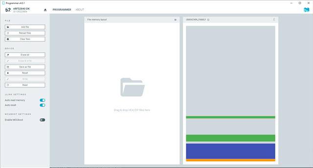

  • I did a bit more testing and discovered that the nRF52840-DK board is responsible for the 'z' output to the terminal. With or without my board connected, it does this anytime the default BLE app code is present on it. (Turn on the BLE app with the DK board erased and it automatically programs this code.) With the DK board erased, the terminal no longer outputs anything, even with my board connected. Should the NRF_LOG_INFO function work with my board connected through the DK board or do I need a direct connection to my PC?

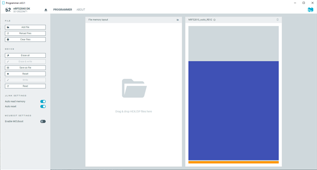

    Something else I noticed, and this may be totally unrelated, was that reading back the program on the DK board showed the MBR, softdevice, and application areas, but when I do the same on my board it only shows the MBR and softdevice. (See below.) The thing is, I can see my device advertising, and the device name, etc. is correct. Wouldn't that imply that the application is present?

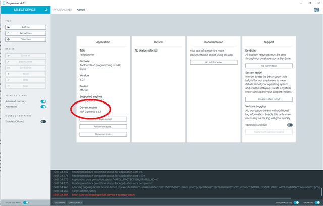

    Yes and no, looking at the last replies you made I still get the sense that you are actually working on the nRF5 SDK, and not the nRF Connect SDK. At least the descriptions "NRF_LOG_INFO", "MBR", "softdevice and application area" all seem to point to nRF5 SDK. So based on that my initial reponse still seem to be valid?
