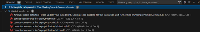

cannot open source file
      When I build a routine project, the terminal window shows that the build was successful, but the problems window reports a bunch of errors to me.
      I followed the solution of others at DEVZONE and added the following path to the c_cpp_properties.json file.

    But the error has not been resolved. Please give me some suggestions, thank you!
Parents Reply
    jinrong said:
    Thank you for explaining the reason.
    No problem at all - I too know that these 'problems' can be very confusing at first, and I know that our VSC developers are working to have this fixed completely. In the meantime it would be great if you just ignored the 'problems' tab - all the interesting information for your compilation will be accessible in the buildlog! :)
