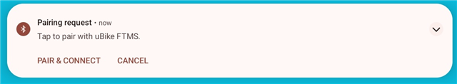

    There is one specific thing I would like to point out for all failures - I expose a writeable characteristic (0x2AD - FTMS control point) and anytime the Android devices attempt to write to this characteristic I see a "Pairing Request" on the Android device.  When I have a connection failure the "Pairing Request" does not appear.
    Questions:
    • What triggers the 'Pairing request' requirement for a given characteristic? I know that is an Android feature, not part of Nordic SDK, but I suspect something I am doing about how that characteristic is advertised requires that confirmation.
      • Specifically, this seems closely related to the failures and I wonder if this pairing confirmation wasn't required if there wouldn't be an issue.
    • How am I getting into a state where it appears connected but notifications fail?
    Some of these cases are clearly failures to connect while others are successful connections that cannot trigger notifications.  I suspect something about the 'pairing request' handshake is leaving the device(s) (both nRF52 and Android app) in a bad state.  Possibly if I don't acknowledge the pair request in time connection fails un-gracefully and that's why it appears connected but notifications fail?
