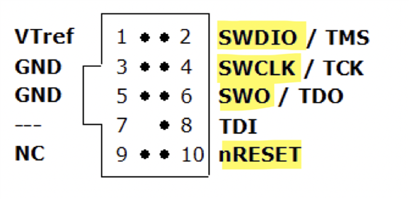

I have a custom PCB with the Fanstel BC832 module. I don't have the inductors for DCDC converter added to my board. I had my entire project written and working with PlatformIO, and everything had been working perfectly, except for the power consumption -- working with PlatformIO had my power consumption plateau at about 8 mA which was unacceptable for my application. So then, we adapted our code using Zephyr and the nRF Connect SDK (v17.1.0) using Visual Studio Code. We got the code working perfectly on both the nRF52DK and the Fanstel nRF52832 EB, with no issues ever, and our current was down to about 2 mA. However, when flashing the code onto our custom PCB's, we've had a few random modules become absolutely bricked, to the point where they're not detected with the J-Link interface anymore (pinout of my connector, which matches that of the DK, is shown in the attached picture -- all the yellow highlighted, plus VTref and GND are included. Module is powered independently during flashing). The device is not recognized as a Nordic device anymore using nRF Desktop either. The only workaround we've had is to unsolder the BC832 module and start over with a fresh one.
