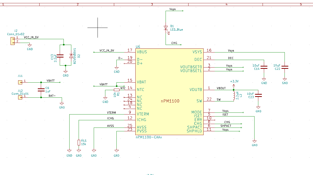

We are implementing npm1100 in our project. I'm measuring about 4mA without any load connected.
Please see circuit below:
Did I made anything wrong?

Your schematic looks ok.

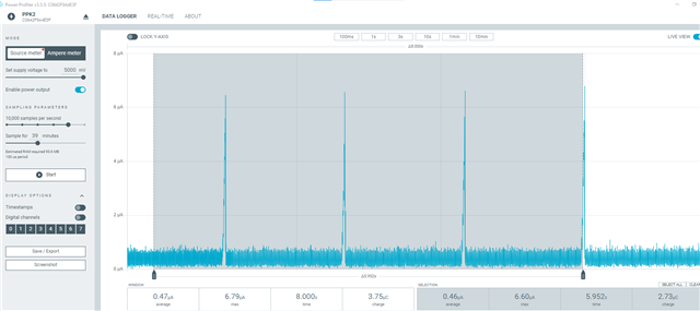

I have measured VBAT current without any load and it was 4.6 MA. Then I try to enter ship mode by pressing SHPACt button, which reduces the current to 0.47 uA.

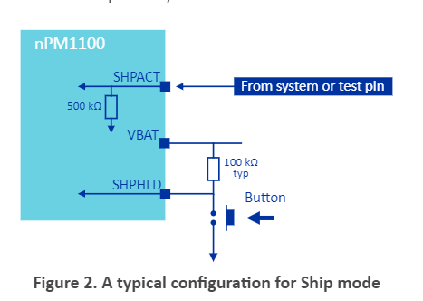

Ship mode isolates the battery, reducing quiescent current. To enter Ship mode, SHPACT must be set high for a minimum period of tactiveToShip when VBUS is disconnected and SHPHLD held high (VIH) (https://infocenter.nordicsemi.com/topic/ps_npm1100/product_overview.html?cp=7_0_0_2_4#ship_mode).

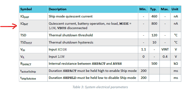

In the datasheet the typical quiescent current is 800nA. This is correct?
My application need a very low quiescent current. Today I use a regulator that drain 1.9uA, I was hoping that npm1100 had a better performance.
Is npm1100 suitable for my application?
Thanks
''In the datasheet the typical quiescent current is 800nA. This is correct?''
yes, it is correct.

Looking at your schematic once again I can see MODE pin is connected to VSYS. Setting MODE to VSYS causes the BUCK to operate in PWM mode. This causes extra current consumption (4.5mA) (unfortunately not quite well documented in PS) (https://infocenter.nordicsemi.com/topic/ps_npm1100/chapters/core_components/buck/doc/frontpage.html?cp=7_0_0_5_2_1#buck_mode_selection)
Ship mode isolates the battery, reducing quiescent current. If using SHIPMODE feature, SHPHLD cannot be connected to VSYS because VSYS is 0V in SHIPMODE and it will wake-up the device. Instead, it must be connected to VBAT through a pull-up resistor. See https://infocenter.nordicsemi.com/topic/ps_npm1100/chapters/application/doc/frontpage.html?cp=7_0_0_6_6#unique_2037983651
There are two ways to exit Ship mode. Either connect the USB (VBUS) or set SHPHLD low for a minimum period of 200ms. The battery supply (VBAT) is used to hold SHPHLD high through a weak pull-up resistor when Ship mode is enabled.
If Ship mode is not required, then SHPACT and SHPHLD pins may be tied to AVSS.
