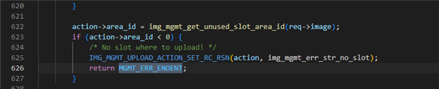

    Error 5 in the log "Image upload inspect failed: 5" means :     MGMT_ERR_ENOENT  /** No such file/entry. */
    It seems that the mcu_mgr couldn't find the mcuboot_secondary for some reason.
