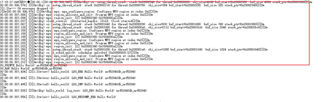

case about CONFIG_LOG_DEFAULT_LEVEL=4 case nRF52840 error
1. Please help me resolve the log error that occurs with CONFIG_LOG_DEFAULT_LEVEL=4
2. I created a very simple example of log printing and it worked fine when I set CONFIG_LOG_DEFAULT_LEVEL=3.
3. When I set CONFIG_LOG_DEFAULT_LEVEL=4, the printed log shows the error message as follows:
4. The code is as follows:
[17:18:27.649]收←◆[00:00:1[00:00:00.306,945] <dbg> os: setup_thread_stack: stack 0x20002340 for thread 0x20000828: obj_size=4160 buf_start=0x20002380  buf_size 4096 stack_ptr=0x20003380
[00:00:00.306,976] <dbg> os: setup_thread_stack: stack 0x200021c0 for thread 0x20000788: obj_size=384 buf_start=0x20002200  buf_size 320 stack_ptr=0x20002340
--- 24 messages dropped ---

5. Test environment:
ncs v2.4.0
DK:PCA10056 3.0.0
Thank you for all your assistance.
Peter.Min
    I am a bit confused regarding what error you see. When raising the log level you will get more log messages, and none of the messages looks like error messages. To me it looks like no errors? Please point out the specific error, and we may have a look.
    If the error is the squares that you see, then this is typically special characters or special character combinations for changing text color on certain terminals. You can turn off color codes through CONFIG_LOG_BACKEND_SHOW_COLOR=n, and/or CONFIG_LOG_INFO_COLOR_GREEN=n (in your prj.conf.)
    Terje

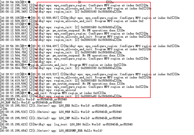

  • Hi tesc,
    [16:32:22.338]收←◆[00:0[00:00:00.322,265] <dbg> mpu: mpu_configure_region: Configure MPU region at index 0x2
    [00:00:00.330,780] <dbg> mpu: region_allocate_and_init: Program MPU region at index 0x2
    [00:00:00.339,447] <dbg> mpu: region_init: [2] 0x20001a00 0x150b000a

    log_test() in while (1) is printed every 3 seconds when CONFIG_LOG_DEFAULT_LEVEL=3
    log_test() in while (1) when CONFIG_LOG_DEFAULT_LEVEL=4; The log is not printed every 3 seconds, During this process you can see the chip automatically reset
    Peter.Min
    One potential issue is sometimes logging may take too much time, preventing time critical operations. That may be what is happening here, especially if you are not using deferred logging mode. You can turn on deferred logging through CONFIG_LOG_MODE_DEFERRED=y.
    Terje
  • Hi test,
    1. set  CONFIG_LOG_MODE_DEFERRED=y is ok.
    [16:39:45.065]收←◆[00:00:02.238,555] <dbg> mpu: mpu_configure_region: Configure MPU region at index 0x2

    [00:00:15.295,532] <wrn> app: LOG_WRN Hello World! nrf52840dk_nrf52840
    [00:00:15.295,593] <inf> app: LOG_INF Hello World! nrf52840dk_nrf52840
    [00:00:15.295,623] <dbg> app: log_test: LOG_DBG Hello World! nrf52840dk_nrf52840
    [00:00:15.295,654] <err> app: LOG_HEXDUMP_ERR Hello World!
                                  6e 72 66 39
    [16:39:57.250]收←◆31 36 30 64  6b 5f 6e 72 66 39 31 36 |nrf9160d k_nrf916
                                  30                                               |0
    [00:00:15.295,654] <wrn> app: LOG_HEXDUMP_WRN Hello World!
                                  6e 72 66 39 31 36 30 64  6b 5f 6e 72 66 39 31 36 |nrf9160d k_nrf916
                                  30                                               |0
    [00:00:15.295,684] <inf> app: LOG_HEXDUMP_INF Hello World!
                                  30                                               |0
    [00:00:15.295,715] <dbg> app: log_test: LOG_HEXDUMP_DBG Hello World!
                                  30
    [16:39:57.331]收←◆                                    |0
    [00:00:15.295,745] <dbg> mpu: mpu_configure_region: Configure MPU region at index 0x2
    [00:00:15.295,776] <dbg> mpu: region_allocate_and_init: Program MPU region at index 0x2
    [00:00:15.295,776] <dbg> mpu: region_init: [2] 0x20003180 0x150b000a
    2.But how do I configure prj.conf to turn off the mpu part of the log
    Peter.Min
    You can set MPU log level through the CONFIG_MPU_LOG_LEVEL_* options, where * is one of DBG, DEFAULT, ERR, INF, OFF or WRN. So for instance CONFIG_MPU_LOG_LEVEL_OFF=y should turn off all logging for MPU.
    Terje
  • Hi tesc,
    Your suggestion is very good
    log printing is ok after the following modification
    #CONFIG_MPU_LOG_LEVEL_ERR=y
    #CONFIG_MPU_LOG_LEVEL_WRN=y
    #CONFIG_MPU_LOG_LEVEL_INF=y
    #CONFIG_MPU_LOG_LEVEL_DBG=y
    CONFIG_KERNEL_LOG_LEVEL_OFF=y
    #CONFIG_KERNEL_LOG_LEVEL_ERR=y
    #CONFIG_KERNEL_LOG_LEVEL_WRN=y
    #CONFIG_KERNEL_LOG_LEVEL_INF=y
    #CONFIG_KERNEL_LOG_LEVEL_DBG=y
    Peter.Min
