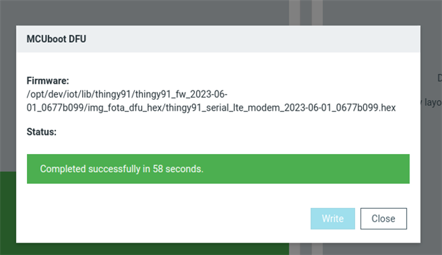

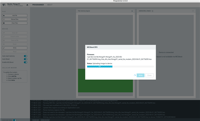

I had already downloaded the current firmware+applications version (thingy91---hardware-files-1_6_0.zip) and I was able to upload the firmware and the thingy91_serial_lte_modem_2023-06-01_0677b099.hex applicatoioon according to the video instructions (with MCUboot mode enabled).

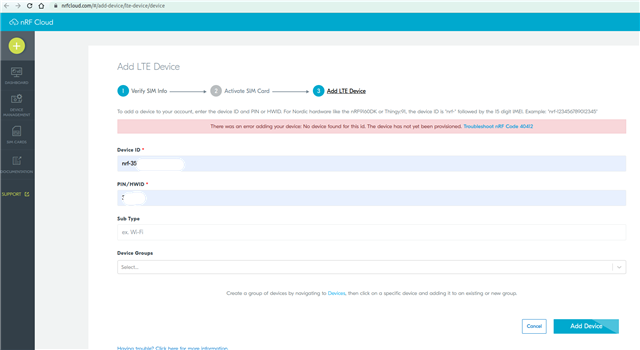

I selected the plus button at top left, then "Add new LTE Device".

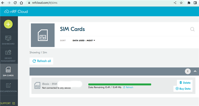

On the first page of the wizard i entered the required data and the check seemingly passed. I'm not sure how relevant this page is (it shows that there is no iBASIS coverage here in Bulgaria) but the activation passed and later I could see the card listed in the "SIM Cards" tab.
On the third page after filling in the required fields clicking the Add Device presented me with error with code 40412 and link to this relevant page for troubleshooting.
The problem is that after this step the LEDs stopped and the device remained dark. I tried the suggested solutions but no matter what cable I use the device can not be seen anymore on any linked computer and can't be seen in the Select Device menus in any of the applications on any of the computers that it was successfully linked to previously.

    When updating the modem FW over MCUBoot/USB, this will erase the whole flash including the application. This is why your device is no longer flashing, and you will need to reprogram the application as well.
    You should follow the Getting started with Thingy:91, which is more up to date than the video you are referring to.
    After updating the modem FW you should program the Asset Tracker v2 application, which is found in our pre-compiled FW package (under the downloads tab on the Thingy:91 product page). Make sure to program the img_fota_dfu_hex/thingy91_asset_tracker_v2_2023-06-01_0677b099.hex if using MCUBoot. See more information in the Getting started guide.

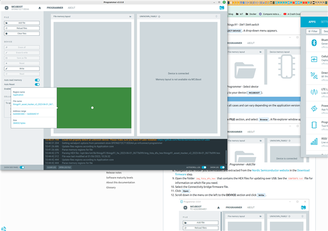

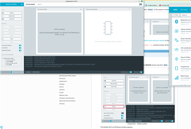

    The first step (updating the nRF52840 SoC firmware) went fine:

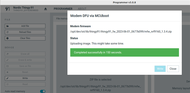

    After that, on the second step (updating the firmware for the nRF9160 SiP) thing started to diverge from the documentation instructions:

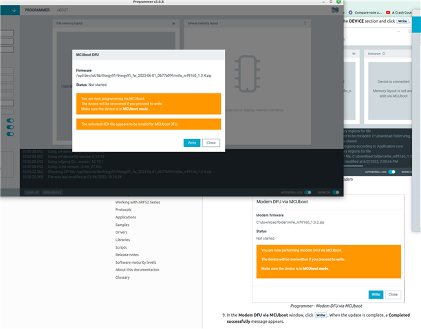

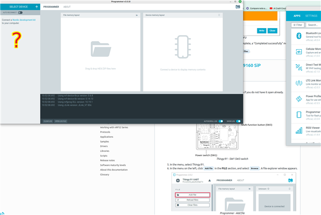

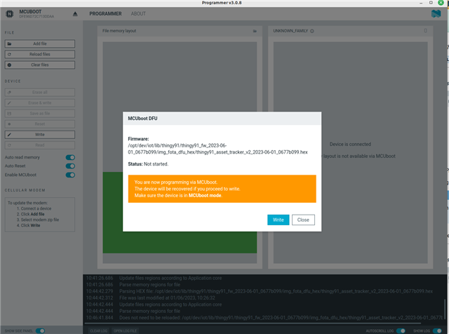

    At first the device doesn't appear at all in the "Select Device" menu:
    And then even despite the fact I try to write the firmware ZIP file, I can select it but the Programmer gives me the following warning and the Write button is not responsive:
    Any ideas?

  • Ivan, I think I see the problem.
    Here it seems that you have programmed the wrong file. The nRF52840 is what provides the USB connection, but it needs the Connectivity Bridge (img_fota_dfu_hex\thingy91_nrf52_connectivity_bridge_2023-03-02_8f26142b.hex).
    Can you please reprogram the nRF52840 with that image, and then program the nRF9160 with the Asset Tracker v2?
    Thanks!

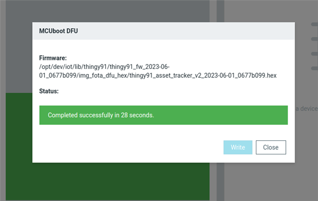

  • Ahh! Now that's more like it. Three simple steps of uploading the three correct files in the correct order. Now it's blinking again.
    I guess the CONTENTS.txt file is not clear enough for beginners like me and the concept of bridge first, firmware next, and asset tracker application in the end somehow is a core knowledge that I missed.

    If at this point I go to the nrfCloud and try to register the Thingy as an LTE device it rightfully responds with the 40412 error, even with correct values for Device ID and PIN.

    From the 40412 error description we see that there are 5 scenarios which can report this error code.
    1. You entered the device id and/or ownership code (PIN or HWID) incorrectly.
    2. Before attempting association, you did not wait for the LEDs to indicate the device was provisioned.
    3. Corrupt modem firmware.
    4. Corrupt, wrongly flashed, or illegitimate device certificates.
    5. Poor LTE connection
    Do you have access to another SIM, i.e. local SIM which has LTE-M/NB-IoT enabled to verify connection/iBasis issues?
