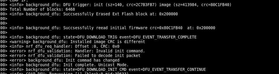

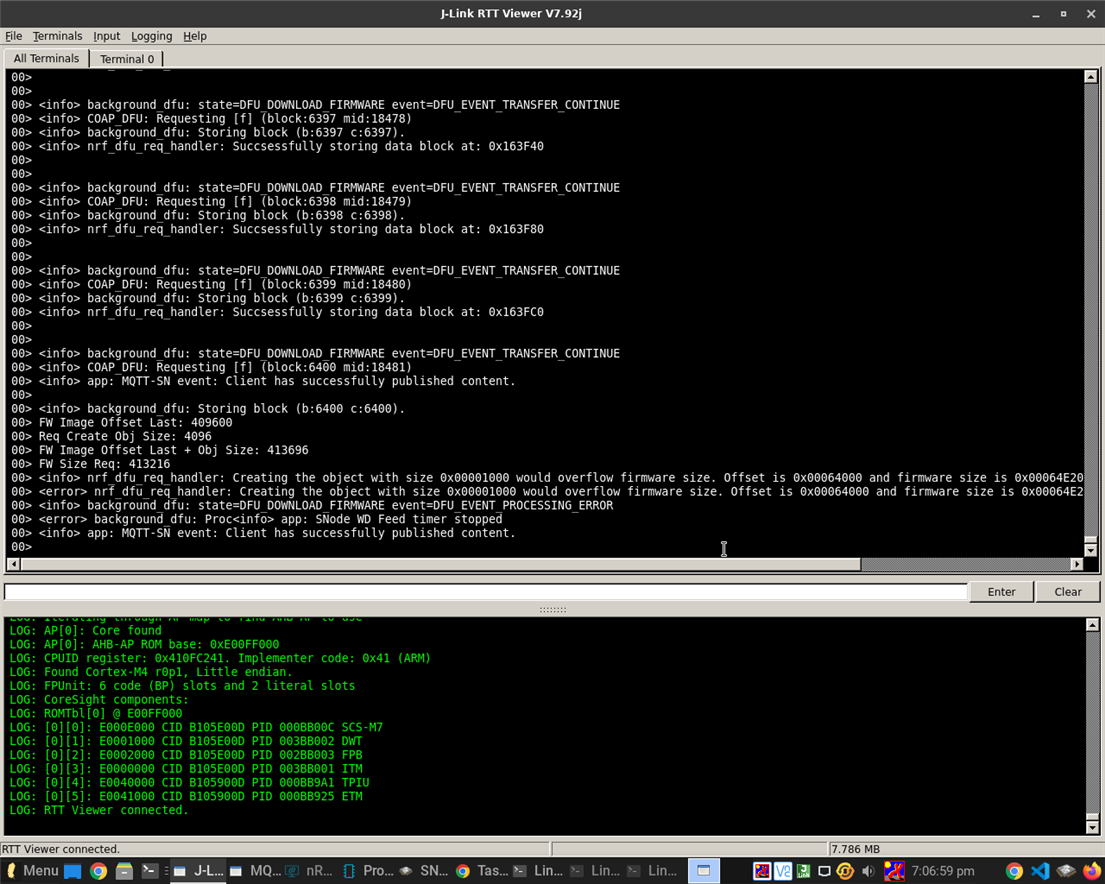

OFF CHIP OTA UPDATE using external flash
I am working on this project off chip ota update on nRF5_SDK  using ecample/thread/dfu
by now, i have done changes in these functions on_data_obj_create_request() and on_data_obj_write_request(). initially these functions were erasing and writing data in internal flash which I changed to qspi functions like nrf_drv_qspi_erase() and nrf_drv_qspi_write(). and it works perfectly.
Later i changed functions for hash verification which is also working but i am not sure about what should be the next step so that bootloader changes the earlier application with the new firmware image.

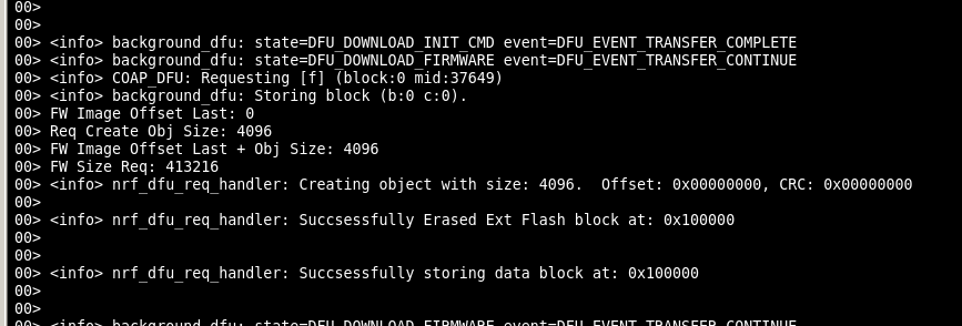

  • I have made three changes in code
    1: in flash erase i have changed it to erase external flash using QSPI.
    static void on_data_obj_create_request(nrf_dfu_request_t * p_req, nrf_dfu_response_t * p_res)
        NRF_LOG_DEBUG("Handle NRF_DFU_OP_OBJECT_CREATE (data)");
        if (!nrf_dfu_validation_init_cmd_present())
            /* Can't accept data because DFU isn't initialized by init command. */
            NRF_LOG_ERROR("Cannot create data object without valid init command");
            p_res->result = NRF_DFU_RES_CODE_OPERATION_NOT_PERMITTED;
            return;

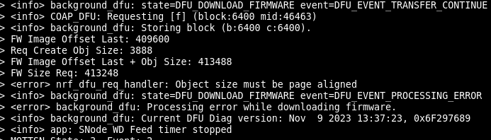

        if (p_req->create.object_size == 0)
            NRF_LOG_ERROR("Object size cannot be 0.")
            p_res->result = NRF_DFU_RES_CODE_INVALID_PARAMETER;
            return;
        if (  ((p_req->create.object_size & (CODE_PAGE_SIZE - 1)) != 0)
            && (s_dfu_settings.progress.firmware_image_offset_last + p_req->create.object_size != m_firmware_size_req))
            NRF_LOG_ERROR("Object size must be page aligned");
            ota_error_code = 1;
            return;
        if (p_req->create.object_size > DATA_OBJECT_MAX_SIZE)
            /* It is impossible to handle the command because the size is too large */
            NRF_LOG_ERROR("Invalid size for object (too large)");
            p_res->result = NRF_DFU_RES_CODE_INSUFFICIENT_RESOURCES;
            return;
        if ((s_dfu_settings.progress.firmware_image_offset_last + p_req->create.object_size) >
            NRF_LOG_ERROR("Creating the object with size 0x%08x would overflow firmware size. "
                          "Offset is 0x%08x and firmware size is 0x%08x.",
                          p_req->create.object_size,
                          s_dfu_settings.progress.firmware_image_offset_last,
                          m_firmware_size_req);
            ota_error_code = 2;
            return;
        s_dfu_settings.progress.data_object_size      = p_req->create.object_size;
        s_dfu_settings.progress.firmware_image_crc    = s_dfu_settings.progress.firmware_image_crc_last;
        s_dfu_settings.progress.firmware_image_offset = s_dfu_settings.progress.firmware_image_offset_last;
        s_dfu_settings.write_offset                   = s_dfu_settings.progress.firmware_image_offset_last;
        /* Erase the page we're at. */
        if (nrf_dfu_flash_erase((m_firmware_start_addr + s_dfu_settings.progress.firmware_image_offset),
                                CEIL_DIV(p_req->create.object_size, CODE_PAGE_SIZE), NULL) != NRF_SUCCESS)
            NRF_LOG_ERROR("Erase operation failed");
            p_res->result = NRF_DFU_RES_CODE_INVALID_OBJECT;
            return;
        NRF_LOG_DEBUG("Creating object with size: %d. Offset: 0x%08x, CRC: 0x%08x",
                     s_dfu_settings.progress.data_object_size,
                     s_dfu_settings.progress.firmware_image_offset,
                     s_dfu_settings.progress.firmware_image_crc);
       NRF_LOG_INFO("Creating object with size: %d.  Offset: 0x%08x, CRC: 0x%08x\r\n",

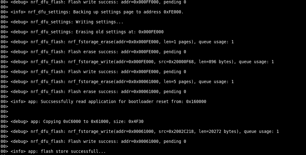

          /* check if flash is enabled */
            if(is_flash_enable() == false)
              NRF_LOG_INFO("Flash in sleep state. Reinintialising\r\n");
              Enable_Flash();
            if(nrf_drv_qspi_erase(NRF_QSPI_ERASE_LEN_4KB, FIRMWARE_FLASH_ADDR + (s_dfu_settings.progress.firmware_image_offset)) != NRFX_SUCCESS)
              NRF_LOG_INFO("Failed to rrase data blocks in Ext Flash.\r\n");
            else
              NRF_LOG_INFO("Succsessfully Erased Ext Flash block at: 0x%X\r\n\r\n",FIRMWARE_FLASH_ADDR + (s_dfu_settings.progress.firmware_image_offset));
              WAIT_FOR_PERIPH();
              nrf_delay_ms(500);

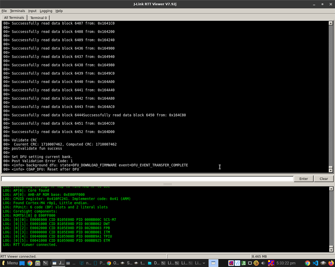

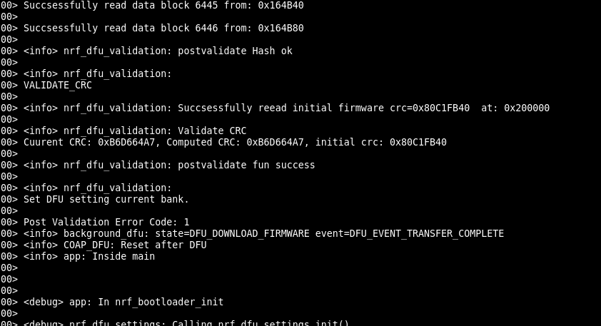

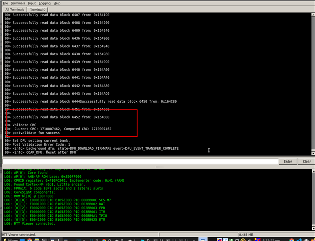

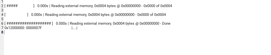

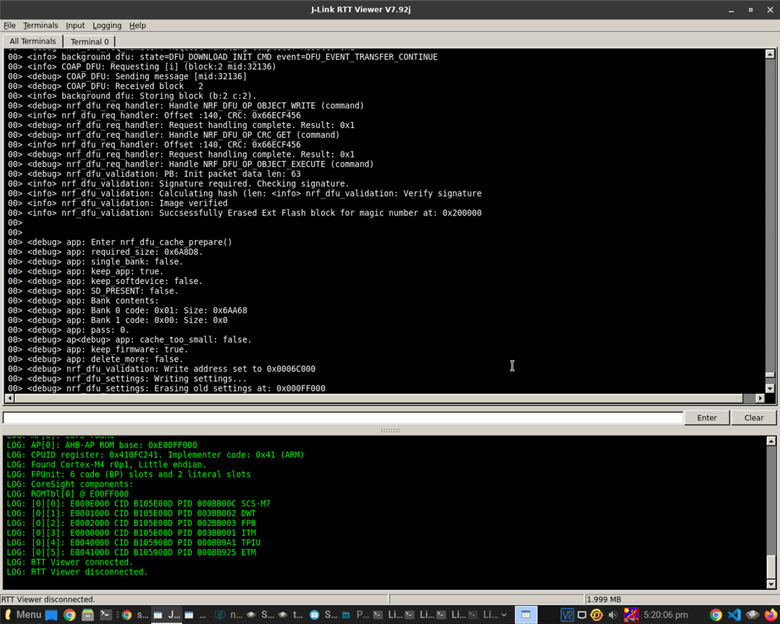

    3: in calculate hash i have changed it to copy data from QSPI and update the hash accordingly.
    ret_code_t nrf_crypto_hash_calculate(nrf_crypto_hash_context_t    * const p_context,
                                         nrf_crypto_hash_info_t       const * p_info,
                                         uint8_t                      const * p_data,
                                         size_t                               data_size,
                                         uint8_t                            * p_digest,
                                         size_t                       * const p_digest_size)
        ret_code_t                      ret_val;
        nrf_crypto_hash_context_t     * p_ctx  = (nrf_crypto_hash_context_t *)p_context;
        void                          * p_allocated_context = NULL;
    // Internal allocation of context not available for CC310_BL in order to save code size.
    #if defined(NRF_CRYPTO_BACKEND_CC310_BL_HASH_SHA256_ENABLED) && (NRF_CRYPTO_BACKEND_CC310_BL_HASH_SHA256_ENABLED == 1)
        // Do nothing
    #elif defined(NRF_CRYPTO_BACKEND_CC310_BL_HASH_SHA256_ENABLED) && (NRF_CRYPTO_BACKEND_CC310_BL_HASH_SHA256_ENABLED == 0)
        // Validate input. Only validate input parameters that are used locally, others are validated
        // in the init, update and/or finalize functions.
        VERIFY_TRUE(p_info != NULL, NRF_ERROR_CRYPTO_INPUT_NULL);
        // Allocate context if needed (not provided by the user).
        if (p_context == NULL)
            p_allocated_context = NRF_CRYPTO_ALLOC(p_info->context_size);
            if (p_allocated_context == NULL)
                return NRF_ERROR_CRYPTO_ALLOC_FAILED;
            p_ctx = (nrf_crypto_hash_context_t *)p_allocated_context;
    #else
        #warning NRF_CRYPTO_BACKEND_CC310_BL_HASH_SHA256_ENABLED define not found in sdk_config.h (Is the sdk_config.h valid?).
    #endif // NRF_CRYPTO_BACKEND_CC310_BL_HASH_SHA256_ENABLED
        ret_val = nrf_crypto_hash_init(p_ctx, p_info);
        NRF_CRYPTO_VERIFY_SUCCESS_DEALLOCATE(ret_val, p_allocated_context);
        if(validation_state == 0)
            ret_val = nrf_crypto_hash_update(p_ctx, p_data, data_size);
            validation_state = 1;
        else
            uint16_t firmware_blocks = data_size / FIRMWARE_BLOCK_SIZE;
            uint8_t rest_block = data_size % FIRMWARE_BLOCK_SIZE;
            printf("data_size: %d", data_size);
            printf("firmware_blocks: %d", firmware_blocks);
            printf("rest_block: %d", rest_block);
            for(uint16_t i=0; i <= firmware_blocks; i++)
                    printf("Flash in sleep state. Reinintialising\r\n");
                    Enable_Flash();
                uint8_t m_buffer_rx[FIRMWARE_BLOCK_SIZE];
                if(i == firmware_blocks)
                    if(nrf_drv_qspi_read(m_buffer_rx, rest_block,FIRMWARE_FLASH_ADDR + (FIRMWARE_BLOCK_SIZE * i)) != NRFX_SUCCESS)
                       printf("\r\nFailed read data blocks in Ext Flash.\r\n");
                    else
                       printf("Succsessfully read rest_block data block from: 0x%X\r\n\r\n",FIRMWARE_FLASH_ADDR + (FIRMWARE_BLOCK_SIZE * i));
                       WAIT_FOR_PERIPH();
                       ret_val = nrf_crypto_hash_update(p_ctx, m_buffer_rx, rest_block);
                else
                    if(nrf_drv_qspi_read(m_buffer_rx, FIRMWARE_BLOCK_SIZE,FIRMWARE_FLASH_ADDR + (FIRMWARE_BLOCK_SIZE * i)) != NRFX_SUCCESS)
                    else
                        printf("Succsessfully read data block %d from: 0x%X\r\n\r\n", i ,FIRMWARE_FLASH_ADDR + (FIRMWARE_BLOCK_SIZE * i));
                        WAIT_FOR_PERIPH();
                        ret_val = nrf_crypto_hash_update(p_ctx, m_buffer_rx, FIRMWARE_BLOCK_SIZE);
            validation_state = 0;
        ret_val = nrf_crypto_hash_finalize(p_ctx, p_digest, p_digest_size);
    #if !NRF_MODULE_ENABLED(NRF_CRYPTO_BACKEND_CC310_BL_HASH_SHA256)
        // Free context if allocated internally
        if (p_allocated_context != NULL)
            NRF_CRYPTO_FREE(p_allocated_context);
    #endif // !NRF_MODULE_ENABLED(NRF_CRYPTO_BACKEND_CC310_BL_HASH_SHA256)
        return NRF_SUCCESS;
    #endif // NRF_MODULE_ENABLED(NRF_CRYPTO_HASH)
    #endif // NRF_MODULE_ENABLED(NRF_CRYPTO)

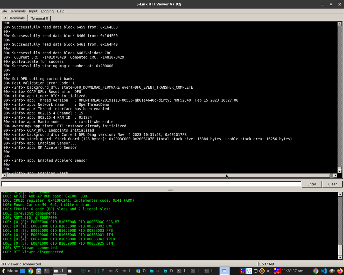

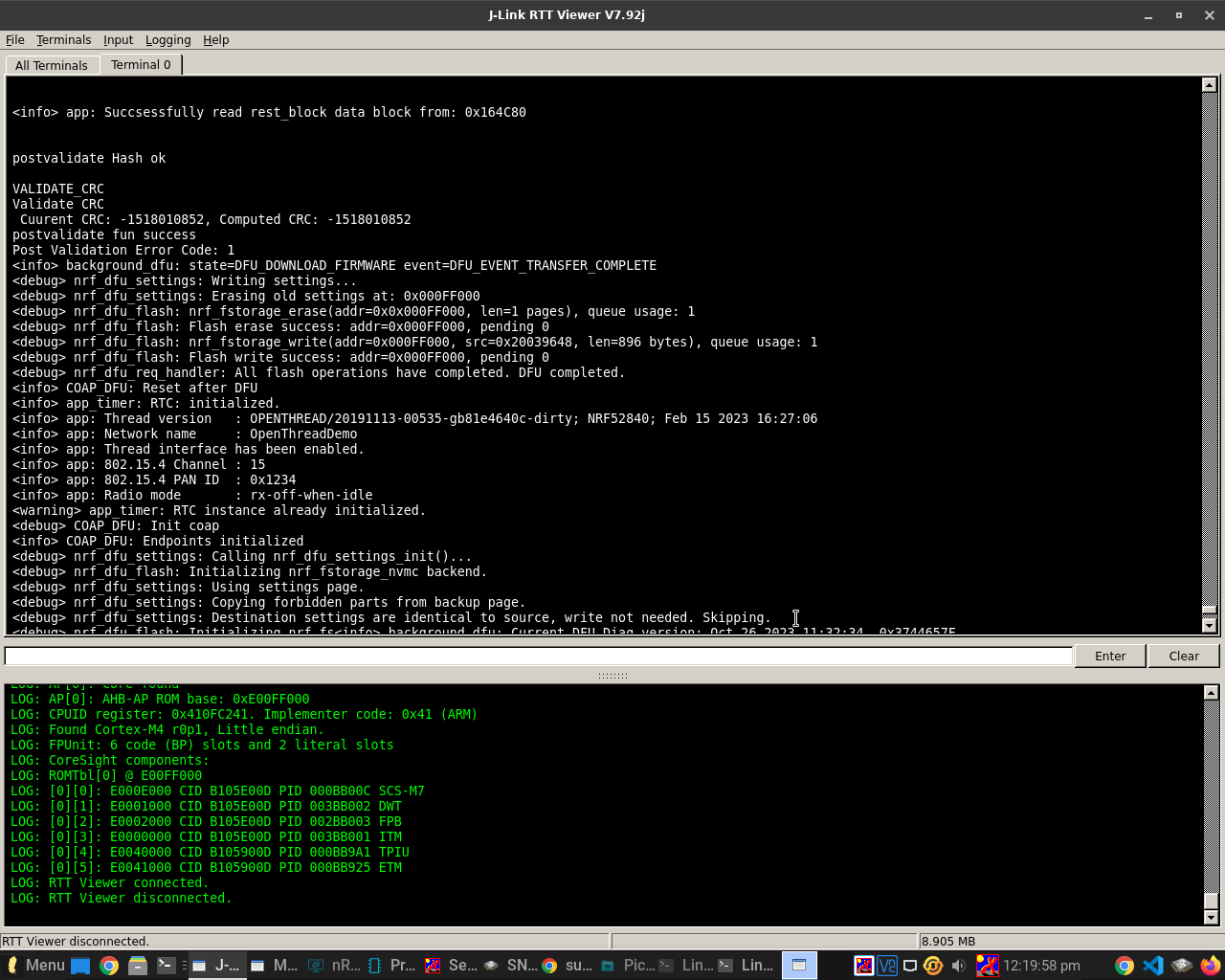

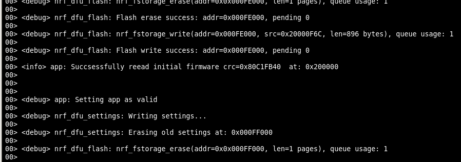

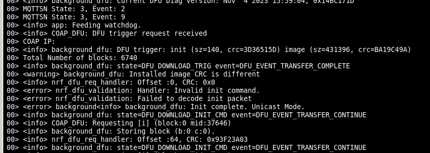

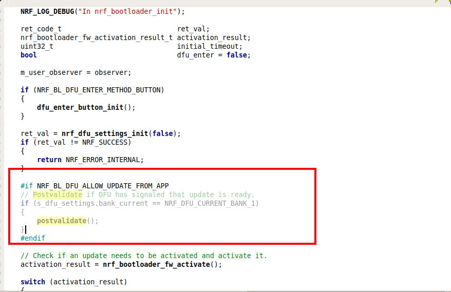

    and after that few more changes to get notified that hash has been verified and also to find out flow of the code
    1
    #if NRF_DFU_IN_APP
            res.result = nrf_dfu_validation_post_data_execute(m_firmware_start_addr, m_firmware_size_req);
            printf("Post Validation Error Code: %d\r\n",res.result );
            #else
            res.result = nrf_dfu_validation_activation_prepare(m_firmware_start_addr, m_firmware_size_req);
    2 and in this this change i didn't find the output after this  if (!is_trusted). may be this piece of code is not executing or something
    nrf_dfu_result_t postvalidate(uint32_t data_addr, uint32_t data_len, bool is_trusted)
        nrf_dfu_result_t           ret_val = NRF_DFU_RES_CODE_SUCCESS;
        dfu_init_command_t const * p_init  = mp_init;
        if (!fw_hash_ok(p_init, data_addr, data_len))
            ret_val = EXT_ERR(NRF_DFU_EXT_ERROR_VERIFICATION_FAILED);
        else
            printf("postvalidate Hash ok\r\n");
            if (p_init->type == DFU_FW_TYPE_APPLICATION)
                if (!postvalidate_app(p_init, data_addr, data_len, is_trusted))
                    ret_val = NRF_DFU_RES_CODE_INVALID_OBJECT;
                    printf("postvalidate fun error: postvalidate_app %d\r\n",ret_val);
                else
                  printf("postvalidate fun success\r\n");
    #if NRF_DFU_SUPPORTS_EXTERNAL_APP
            else if (p_init->type == DFU_FW_TYPE_EXTERNAL_APPLICATION)
                if (!is_trusted)
                    // This function must be implemented externally
                    ret_val = nrf_dfu_validation_post_external_app_execute(p_init, is_trusted);
                else
                    s_dfu_settings.bank_1.bank_code = NRF_DFU_BANK_VALID_EXT_APP;
    #endif // NRF_DFU_SUPPORTS_EXTERNAL_APP
            else
                bool with_sd = p_init->type & DFU_FW_TYPE_SOFTDEVICE;
                bool with_bl = p_init->type & DFU_FW_TYPE_BOOTLOADER;
                if (!postvalidate_sd_bl(p_init, with_sd, with_bl, data_addr, data_len, is_trusted))
                    if (is_trusted && with_sd && !DFU_REQUIRES_SOFTDEVICE &&
                        (data_addr == nrf_dfu_softdevice_start_address()))
                        nrf_dfu_softdevice_invalidate();
        if (!is_trusted)
            if (ret_val == NRF_DFU_RES_CODE_SUCCESS)
                    printf("\r\nSet DFU setting current bank.\r\n");
                s_dfu_settings.bank_current = NRF_DFU_CURRENT_BANK_1;
            else
                printf("nrf_dfu_settings_progress_reset if !is_trusted\r\n");
                nrf_dfu_settings_progress_reset();
        else
            printf("Mark the update as complete and valid.\r\n");
                // Mark the update as complete and valid.
                s_dfu_settings.bank_1.image_crc  = crc32_compute((uint8_t *)data_addr, data_len, NULL);
                s_dfu_settings.bank_1.image_size = data_len;
            else
                nrf_dfu_bank_invalidate(&s_dfu_settings.bank_1);
                        printf("Mark the update as Invalid. : %d\r\n",ret_val);
            printf("nrf_dfu_settings_progress_reset if is_trusted\r\n");
            s_dfu_settings.progress.update_start_address = data_addr;
        return ret_val;
    3

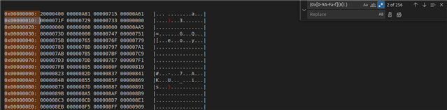

  • I would still like you to verify that the updated binary stored in the bank 0 matches the binary you uploaded through DFU. Since you are not able to read data from your external flash, you can program the hex file of your new application to the device, then read out the memory. Then, repeat the same steps but when loading the image through DFU and not via the debug interface.
    If the images are identical, then that suggests that the CRC computed by the application and the one computed by the bootloader were not computed over the same area.
  • I simply flashed the same application twice using j link(not dfu) by following all the steps .
    and still there is difference in both hex files.

  • Priyesh Shahi said:
    < 0x00063C60: 20206365 30322037 31203332 39313A38 |ec 7 2023 18:19|
    < 0x00063C70: 0038323A 6F727245 6E692072 61687320 |:28.Error in sha|
    > 0x00063C60: 20206365 30322037 31203332 33323A38 |ec 7 2023 18:23|
    > 0x00063C70: 0035353A 6F727245 6E692072 61687320 |:55.Error in sha|
    I see there's a timestamp here. I guess it might be showing when the firmware was built? Regardless, you need to ensure you are programming the same hex file ever time. The DFU image must also be from the same build.
  • Sorry, I was using different build files for comparison.
    After using the same build files, there is no difference in the application area. The only distinction lies in the settings area of the flash. This time, I'm comparing direct flash and flash after DFU.
    Perhaps the reason for this difference is that I generate different setting files to flash this app on my device.
    dnk124 ~ nrfjprog --memrd 0x0 --n 1048576 > qspi_flash.hex
    dnk124 ~ nrfjprog --memrd 0x0 --n 1048576 > flash.hex
    dnk124 ~ cmp qspi_flash.hex flash.hex
    qspi_flash.hex flash.hex differ: byte 4204678, line 60938
    dnk124 ~ 1 diff qspi_flash.hex flash.hex

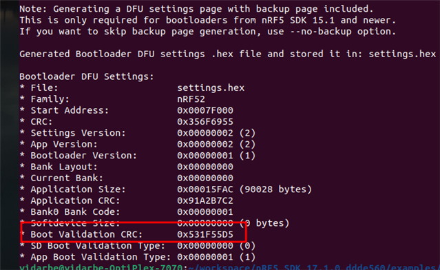

  • It is the FW images that are interesting to compare in this case. If they are identical, then that indicates that everything from receiving the FW image to the QSPI to storing it to bank 0 is being handled correctly.
    Another thing you can try is to generate the settings page with nrfutil and see if it gives the same CRC value as the one computed by the bootloader.
    $ nrfutil nrf5sdk-tools settings generate --application <your application hex> --application-version 2 --bl-settings-version 2 --bootloader-version 1 --family NRF52840 settings.hex
  • Yes, I found the same thing in the initial logs from background_dfu_state.c. There was a CRC that matched the computed CRC in the bootloader. Consequently, I made some changes to the code, and it's currently functioning as expected. Now, I'm in the process of testing it for the final version.
    This log is from the point where the first CRC was printed.
    This is the code I modified in the parse_trigger() function within the background_dfu_state.c file to store that CRC in the external QSPI flash.
    static bool parse_trigger(background_dfu_context_t       * p_dfu_ctx,
                              const background_dfu_trigger_t * p_trigger)
        uint8_t trigger_version = (p_trigger->flags & TRIGGER_FLAGS_VERSION_MASK)
                                        >> TRIGGER_FLAGS_VERSION_OFFSET;
        if (trigger_version <= TRIGGER_VERSION)
            // Base fields available from version 0.
            p_dfu_ctx->init_cmd_size = uint32_big_decode((const uint8_t *)&p_trigger->init_length);
            p_dfu_ctx->init_cmd_crc  = uint32_big_decode((const uint8_t *)&p_trigger->init_crc);
            p_dfu_ctx->firmware_size = uint32_big_decode((const uint8_t *)&p_trigger->image_length);
            p_dfu_ctx->firmware_crc  = uint32_big_decode((const uint8_t *)&p_trigger->image_crc);
            // Mode flag was added in DFU Trigger version 1.
            if (trigger_version >= 1)
                p_dfu_ctx->dfu_mode = (background_dfu_mode_t)((p_trigger->flags
                                        & TRIGGER_FLAGS_MODE_MASK) >> TRIGGER_FLAGS_MODE_OFFSET);
                p_dfu_ctx->reset_suppress = (p_trigger->flags & TRIGGER_FLAGS_RESET_MASK) >>
                                              TRIGGER_FLAGS_RESET_OFFSET;
            else
                p_dfu_ctx->dfu_mode = BACKGROUND_DFU_MODE_UNICAST;
            NRF_LOG_INFO("DFU trigger: init (sz=%d, crc=%0X) image (sz=%d, crc=%0X)",
                         p_dfu_ctx->init_cmd_size,
                         p_dfu_ctx->init_cmd_crc,
                         p_dfu_ctx->firmware_size,
                         p_dfu_ctx->firmware_crc);
                         printf("Total Number of blocks: %d\r\n",p_dfu_ctx->firmware_size/64);
        // Get the dynamic value of firmware_crc from p_dfu_ctx whenever needed
        uint32_t CRC_VAL = p_dfu_ctx->firmware_crc;
        // Create an array and directly initialize it with the dynamic value using a compound literal
        uint32_t CRC_VAL_BUFF[] = { CRC_VAL };
        /* erase the flash */
        if(nrf_drv_qspi_erase(sizeof(CRC_VAL_BUFF), FIRMWARE_CRC_ADDR) != NRFX_SUCCESS)
          NRF_LOG_INFO("Failed to errase data blocks for initial firmware crc.\r\n");
        else
          WAIT_FOR_PERIPH();
          NRF_LOG_INFO("Succsessfully Erased Ext Flash block at: 0x%X\r\n\r\n",FIRMWARE_CRC_ADDR);
        if(nrf_drv_qspi_write(CRC_VAL_BUFF, sizeof(CRC_VAL_BUFF),FIRMWARE_CRC_ADDR) != NRFX_SUCCESS)
          WAIT_FOR_PERIPH();
          NRF_LOG_INFO("\r\nFailed storing initial firmware crc.\r\n");
        else
          WAIT_FOR_PERIPH();
          NRF_LOG_INFO("Succsessfully reead initial firmware crc=0x%X  at: 0x%X\r\n", CRC_VAL, FIRMWARE_CRC_ADDR);
        dfu_total_blocks = p_dfu_ctx->firmware_size/64;
        if (p_dfu_ctx->firmware_size % 64 != 0) {
            dfu_total_blocks += 1;
            return true;
        return false;

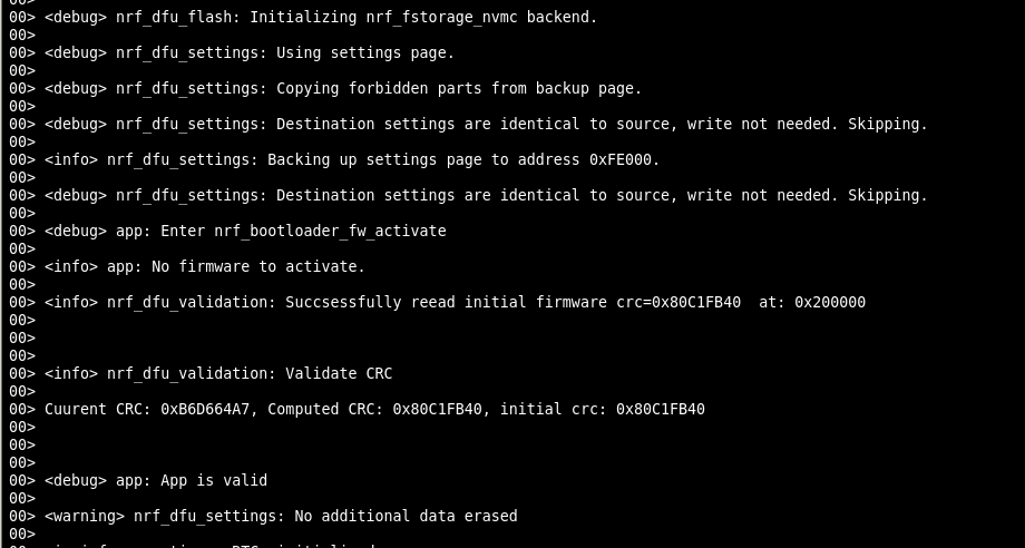

    I later modified the code in the nrf_dfu_validation_boot_validate() function within the nrf_dfu_validation.c file to read the same CRC and validate it against the computed CRC. This function is called twice: first after downloading the complete image in the external flash and then after a bootloader reset as well.
    after first call of this function:
    the second call of this function which comes at the end
    the code which i changed
    bool nrf_dfu_validation_boot_validate(boot_validation_t const * p_validation, uint32_t data_addr, uint32_t data_len)
        uint8_t const * p_data = (uint8_t*) data_addr;
        switch(p_validation->type)
            case NO_VALIDATION:
                return true;
            case VALIDATE_CRC:
                uint32_t current_crc = *(uint32_t *)p_validation->bytes;
                uint32_t crc = crc32_compute(p_data, data_len, NULL);
                //qspi read
                uint32_t read_buffer[1]; // Buffer to store the read value
                // Read the value from QSPI memory into read_buffer (assumed nrf_drv_qspi_read is used)
                if (nrf_drv_qspi_read(read_buffer, sizeof(read_buffer), FIRMWARE_CRC_ADDR) != NRFX_SUCCESS)
                    // Error handling if read fails
                    WAIT_FOR_PERIPH();
                    NRF_LOG_INFO("\r\nFailed reading initial firmware crc.\r\n");
                else
                    // Successful read
                    WAIT_FOR_PERIPH();
                    CRC_VAL = read_buffer[0]; // Extract the read value from the buffer
                NRF_LOG_INFO("Validate CRC\r\nCuurent CRC: 0x%08x, Computed CRC: 0x%08x, initial crc: 0x%08x\r\n",current_crc,crc,CRC_VAL);
                if (!(crc == current_crc || crc == CRC_VAL))
                    // CRC does not match with what is stored.
                    NRF_LOG_DEBUG("CRC check of app failed. Return %d \r\nCuurent CRC: 0x%08x, Computed CRC: 0x%08x", NRF_DFU_DEBUG,current_crc,crc);
                    return NRF_DFU_DEBUG;
                return true;
            case VALIDATE_SHA256:
                return nrf_dfu_validation_hash_ok(p_validation->bytes, data_addr, data_len, false);
            case VALIDATE_ECDSA_P256_SHA256:
                nrf_dfu_result_t res_code = nrf_dfu_validation_signature_check(
                                                DFU_SIGNATURE_TYPE_ECDSA_P256_SHA256,
                                                NRF_CRYPTO_ECDSA_SECP256R1_SIGNATURE_SIZE,
                                                p_data,
                                                data_len);
                return (res_code == NRF_DFU_RES_CODE_SUCCESS);
            default:
                ASSERT(false);
                return false;
    Afterward, I updated the app_activate() function in nrf_bootloader_fw_activation.c to perform the same validation against the computed CRC, and this part is also functioning correctly.
    log of this function
    static uint32_t app_activate(void)
        // This function is only in use when new app is present in Bank 1
        uint32_t const image_size  = s_dfu_settings.bank_1.image_size;
        uint32_t src_addr    = s_dfu_settings.progress.update_start_address;
        uint32_t ret_val     = NRF_SUCCESS;
        uint32_t target_addr = nrf_dfu_bank0_start_addr() + s_dfu_settings.write_offset;
        uint32_t length_left = (image_size - s_dfu_settings.write_offset);
        uint32_t crc;
        NRF_LOG_DEBUG("Enter nrf_dfu_app_continue");
        src_addr += s_dfu_settings.write_offset;
        if (src_addr == target_addr)
            length_left = 0;
        ret_val = image_copy(target_addr, src_addr, length_left, NRF_BL_FW_COPY_PROGRESS_STORE_STEP);
        if (ret_val != NRF_SUCCESS)
            NRF_LOG_ERROR("Failed to copy firmware.");
            return ret_val;
        // Check the CRC of the copied data. Enable if so.
        crc = crc32_compute((uint8_t*)nrf_dfu_bank0_start_addr(), image_size, NULL);
        //qspi read
            WAIT_FOR_PERIPH();
        else
            // Successful read
            WAIT_FOR_PERIPH();
            CRC_VAL_INI = read_buffer[0]; // Extract the read value from the buffer
            NRF_LOG_INFO("Succsessfully reead initial firmware crc=0x%X  at: 0x%X\r\n", CRC_VAL_INI, FIRMWARE_CRC_ADDR);
        if (crc == s_dfu_settings.bank_1.image_crc || crc == CRC_VAL_INI)
            NRF_LOG_DEBUG("Setting app as valid");
            s_dfu_settings.bank_0.bank_code = NRF_DFU_BANK_VALID_APP;
            s_dfu_settings.bank_0.image_crc = crc;
            s_dfu_settings.bank_0.image_size = image_size;
        else
            NRF_LOG_ERROR("CRC computation failed for copied app: "
                          "src crc: 0x%08x, res crc: 0x%08x",
                          s_dfu_settings.bank_1.image_crc,
                          crc);
        return ret_val;
    As of now i have done this process four times and it's working
    I've nearly completed the task at hand, and currently, everything is functioning smoothly. I'm in the process of conducting final tests to ensure everything is perfect. If any difficulties arise, I'll return here for further assistance.
    Thank you for your support throughout this process.

  • Hello  ,
    The recent changes have been effective most of the time, but occasional failures still occur in the CRC calculation following image copying. The CRC obtained from the QSPI sometimes doesn't align with the computed CRC after the image copy process. To address this, I implemented a modification: before copying the image, I perform a CRC calculation on the image stored in the external flash. Subsequently, I added a condition that allows the image to be copied only if these two CRC values match. This solution has been functioning properly. However, a problem arises when a CRC mismatch occurs. I've implemented a flag that triggers the start of the Bank 0 application, but I'm uncertain about the logic behind it.
    I'm considering adjustments to the settings that would prompt the bootloader to restart the Bank 0 application. Any insights on which settings should be modified for this purpose?
      crc = crc32_compute((uint8_t *)nrf_dfu_bank0_start_addr(), image_size, NULL);
      if (crc == s_dfu_settings.bank_1.image_crc || crc == downloaded_crc_val || crc == computed_crc) {
      } else {
            crc);
    Does your bootloader not fall back to the old application when the CRCs don't match?

    // Postvalidate if DFU has signaled that update is ready.
    if (s_dfu_settings.bank_current == NRF_DFU_CURRENT_BANK_1)
    postvalidate();
