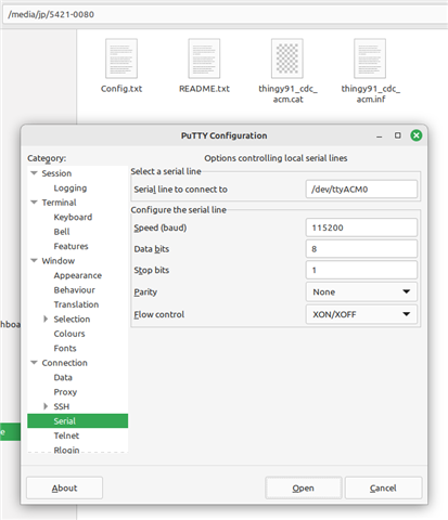

    Still no visible output on ttyACM0? Same thing with other serial consoles, like putty/minicom etc? Could you uncheck the hardware flow control, to ensure it is off?

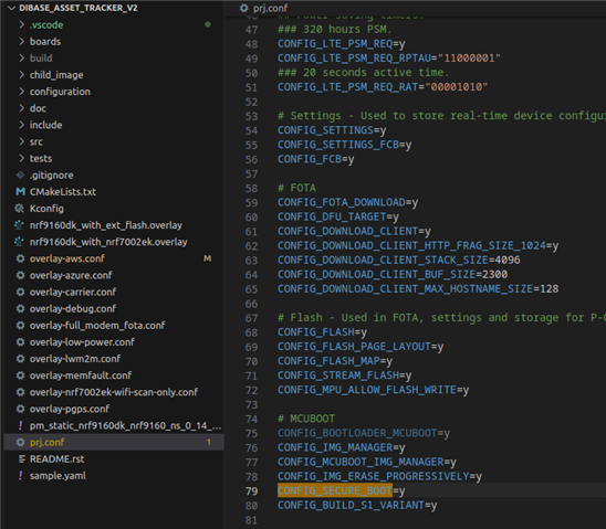

    This has references to subimage "b0" - do you have CONFIG_SECURE_BOOT=y set in your current configuration? Thingy91 is applying a pm_static.yml file, as it expects a certain layout in order for the bootloader over serial to work, which does not include the b0 immutable bootloader, which is automatically attached as a sub-image when setting CONFIG_SECURE_BOOT=y.
    Here's the default pm_static it applies for each project:
    https://github.com/nrfconnect/sdk-nrf/blob/main/boards/arm/thingy91_nrf9160/thingy91_pm_static.yml
    When b0 is added, which is a first-stage bootloader for mcuboot, you will not be able to fit the image onto the flash, as it conflicts with what is statically defined in the above file.
    Haven't tried before. With Putty (the following settings - default for the ST too) nothing happens when I click 'Open':
    Minicom is completely new for me, and I'd need some time with it in order to get used to it.
    I suppose this is the default and I haven't touched it:

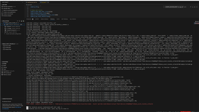

  • I'm putting here the output of the actual build:
    I suspect it could be related to toolchain paths but I can be wrong.
    To be exhaustive:
    This is a direct impact of thingy91 board effectively not supporting CONFIG_SECURE_BOOT, unfortunately.
    Ivan Popov said:
    So far I've always flashed the built apps according to the rules in the documentation (pressed SW3 while switching on SW1, and MCU Boot option switched ON) ... So far I haven't had a case where in the Programmer the green area (the image layout reaches above the half of the designated area (assuming 100% is to the top)).
    But in this case I can't know - the build fails and I don't get to the HEX image to flash.
    Do you mean that the build is limited to a specific memory size and would fail if the image gets calculated to become larger?
    The root problem is that thingy91_nrf9160_ns board is statically setup without having the b0 partition support. The flash layout of thingy91 is effectively set in stone by the formerly linked thingy91_pm_static.yml
    The fix would be to create a completely new board, based on the thingy91 or nrf9160dk board, unfortunately.
