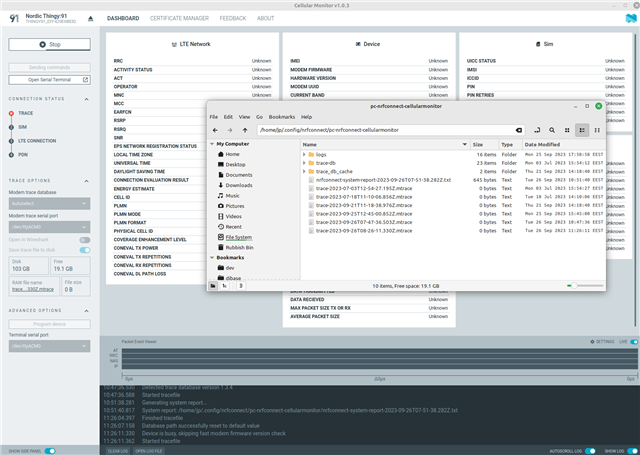

    All of the further development seems to have to be done kind of in the dark. That is because there is still nothing on the serial port. I tried to record a trace in the Cellular Monitor but the UART indicator (this one might be in the LTE Link Monitor actually) at the top only blinks between yellow and red and the trace files written n the file system are always empty:

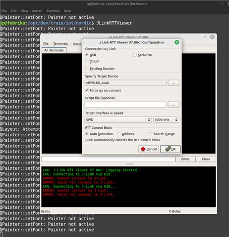

    Also the J-Link RTT Viewer can't connect with the default options:
    Did you configure RTT as uart backend?

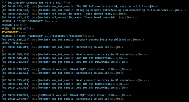

    Do you receive serial output from this sample?
    Later with all other windows closed and nothing else taking up the port I was watching the Serial terminal waiting to see output resembling the one shown here but nothing.
    In AWS IoT Core's MQTT Client I can still initiate pub/sub communication but I'm still seeing none of it in a terminal session.
    I didn't know it requires it's own preliminary configuration - where should I look for this one?

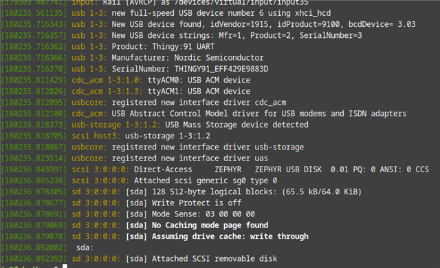

    Q2: Can you share your dmesg output after connecting the thingy91?
    If you haven't actively added any RTT prints, you shouldn't need to use it. Ie. the default is to output on UART with the aws_iot sample.
    As you're using mint - Could it be that brltty is grabbing the other ttyACM device?
    https://askubuntu.com/questions/1454633/dev-ttyusb0-device-connects-then-is-forced-to-disconnect-by-another-device

    Here is the whole dmesg output after I connect the Thingy to the computer:

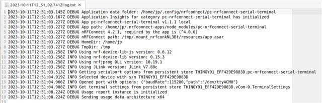

    And here is output in the Serial Terminal (from the file) (the aws_iot sample is flashed on the device):
    As for the brltty problem - I've had it before with another device (as you can see from my answer here), and I've removed it some time ago.

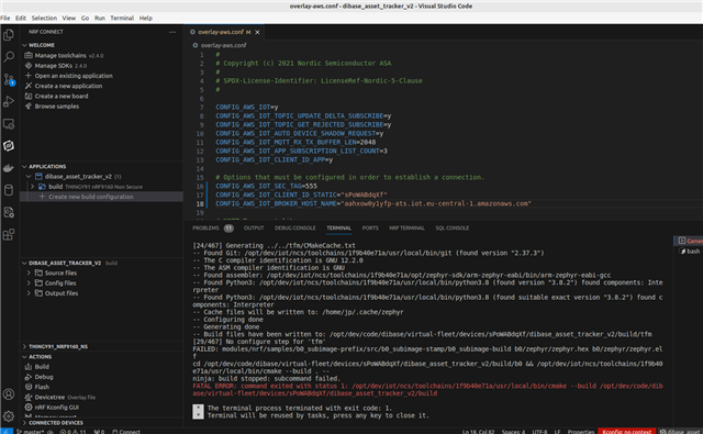

    • the build for the sample fails with the only change to it being the addition of the AWS properties in the respective overlay file (overlay-aws.conf) and the error is addressed in this ticket too:
    ... and since the problem is already different from the one in the title of the ticket, I'm not very sure if I have to close this and open another one, or we just can finish this here?
