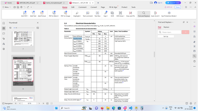

      attaching the screenshot of MEMs microphone.

    Also I think the maxmium and minimum clk frequencies you have specified are incorrect. They should reflect the microphone's specification, which I think, if reading the datasheet correctly is 440 KHz to 5.04 Mhz.
