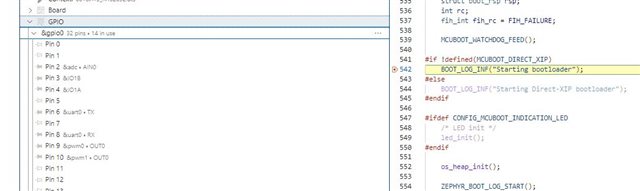

  • Hi Eric,
    It seems that the PWM might be enabled in the bootloader. To verify this, check if the generated .config file in the build output for MCUBoot contains CONFIG_PWM=y. The file can be found in <build dir>/mcuboot/zephyr.
    If it is enabled, I suspect that PWM is being turned on by default in your custom board file. The solution would be to either use a Kconfig overlay file for MCUboot to disable it or modify the board file so that it isn't enabled by default (requiring it to be explicitly enabled in the application).
    My thinking is that I either need to make sure that the bootloaders .dts file (where is it ?)
    You can inspect the generated zephyr.dts file in <build dir>/mcuboot/zephyr.
    Cheers,
    Vidar
