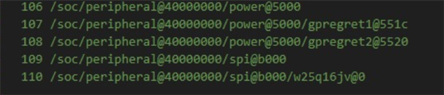

When transitioning to the new version of the SDK, this node this issue:
[275/285] Linking C executable zephyr\zephyr_pre0.elf
FAILED: zephyr/zephyr_pre0.elf zephyr/zephyr_pre0.map .../build/mcuboot/zephyr/zephyr_pre0.map
undefined reference to '__device_dts_ord_110'
Looking into the generated file build/zephyr/mcuboot/include/devicetree_generated.h I see this:
Based on this I decided to remove the external flash node from the custom_board_nrf9160_common.dts and add it to an overlay file for the non-secure part of my application

After doing this, the code built fine.
So the question is why does the external flash is causing an issue to the device tree when it is added in the common dts, but works when it is put on the overlay file?
