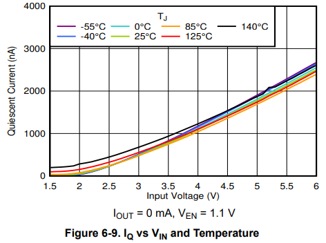

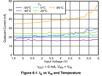

There is no current difference in the TPS7A02 LDO Datasheet.
Does the standby current consumed by the nRF52832 vary depending on the VDD voltage (LDO output)?
