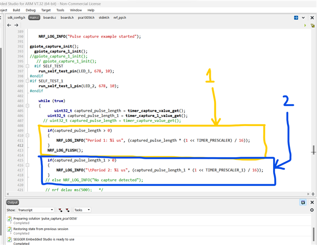

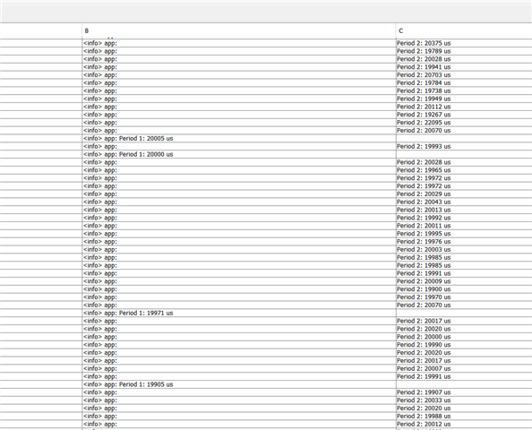

How to Measure Period of input signal at TWO GPIO's
Hi All, I'm trying to capture the TWO pulses at TWO GPIO's by measuring the period of the signal. Im using the following code. This code is perfectly working for 1 Signal at 1 GPIO. After making it for TWO signals at 2 GPIO's - Its working for 1 and not showing for second or showing some values. I checked both by commenting one by one and it seems both programs are working fine but when I try to work for boths its showing one and not responding for other.
The code is attached below,

static void gpiote_capture_init(void)
    uint32_t err_code;
    static nrf_ppi_channel_t ppi_ch_gpiote_capture;
    static nrf_ppi_channel_t ppi_ch_gpiote_restart;
    // Optionally, enable pullup or pulldown on the input pin
    //nrf_gpio_cfg_input(SAMPLE_PIN, NRF_GPIO_PIN_PULLUP);
    // Allocate two PPI channels
    nrfx_ppi_channel_alloc(&ppi_ch_gpiote_capture);
    nrfx_ppi_channel_alloc(&ppi_ch_gpiote_restart);
    // Configure the capture timer
    timer_cfg.frequency = TIMER_PRESCALER;
    timer_cfg.bit_width = NRF_TIMER_BIT_WIDTH_32;
    err_code = nrf_drv_timer_init(&capture_timer, &timer_cfg, empty_timer_handler);
    // The GPIOTE driver doesn't support two GPIOTE channels on the same pin, so direct register access is necessary
    NRF_GPIOTE->CONFIG[GPIOTE_CH_CAPTURE] = GPIOTE_CONFIG_MODE_Event << GPIOTE_CONFIG_MODE_Pos |
                                            GPIOTE_CONFIG_POLARITY_HiToLo << GPIOTE_CONFIG_POLARITY_Pos |
                                            SAMPLE_PIN << GPIOTE_CONFIG_PSEL_Pos;
    NRF_GPIOTE->CONFIG[GPIOTE_CH_RESTART] = GPIOTE_CONFIG_MODE_Event << GPIOTE_CONFIG_MODE_Pos |
                                            GPIOTE_CONFIG_POLARITY_LoToHi << GPIOTE_CONFIG_POLARITY_Pos |
    // Assign a PPI channel to capture the current timer state and store it in CC register 0
    nrfx_ppi_channel_assign(ppi_ch_gpiote_capture,
                            (uint32_t)&NRF_GPIOTE->EVENTS_IN[GPIOTE_CH_CAPTURE],
                            nrf_drv_timer_capture_task_address_get(&capture_timer, 0));
    // Assign a second PPI channel to restart the timer when a new pulse is detected
    nrfx_ppi_channel_assign(ppi_ch_gpiote_restart,
                            (uint32_t)&NRF_GPIOTE->EVENTS_IN[GPIOTE_CH_RESTART],
                            nrf_drv_timer_task_address_get(&capture_timer, NRF_TIMER_TASK_CLEAR));
    // Enable both PPI channels
    nrfx_ppi_channel_enable(ppi_ch_gpiote_capture);
    nrfx_ppi_channel_enable(ppi_ch_gpiote_restart);
    // Make sure the GPIOTE capture in event is cleared. This will be  used to detect if a capture has occured.
    NRF_GPIOTE->EVENTS_IN[GPIOTE_CH_CAPTURE] = 0;
    // Start the timer
    nrfx_timer_resume(&capture_timer);
static void gpiote_capture_1_init(void)
    uint32_t err_code;
    static nrf_ppi_channel_t ppi_ch_gpiote_capture_1;
    static nrf_ppi_channel_t ppi_ch_gpiote_restart_1;
    nrfx_ppi_channel_alloc(&ppi_ch_gpiote_capture_1);
    nrfx_ppi_channel_alloc(&ppi_ch_gpiote_restart_1);
    timer_cfg.frequency = TIMER_PRESCALER_1;
    err_code = nrf_drv_timer_init(&capture_timer_1, &timer_cfg, empty_timer_handler);
    NRF_GPIOTE->CONFIG[GPIOTE_CH_CAPTURE_1] = GPIOTE_CONFIG_MODE_Event << GPIOTE_CONFIG_MODE_Pos |
                                            SAMPLE_PIN_1 << GPIOTE_CONFIG_PSEL_Pos;
    NRF_GPIOTE->CONFIG[GPIOTE_CH_RESTART_1] = GPIOTE_CONFIG_MODE_Event << GPIOTE_CONFIG_MODE_Pos |
    nrfx_ppi_channel_assign(ppi_ch_gpiote_capture_1,
                            (uint32_t)&NRF_GPIOTE->EVENTS_IN[GPIOTE_CH_CAPTURE_1],
                            nrf_drv_timer_capture_task_address_get(&capture_timer_1, 0));
    nrfx_ppi_channel_assign(ppi_ch_gpiote_restart_1,
                            (uint32_t)&NRF_GPIOTE->EVENTS_IN[GPIOTE_CH_RESTART_1],
                            nrf_drv_timer_task_address_get(&capture_timer_1, NRF_TIMER_TASK_CLEAR));
    nrfx_ppi_channel_enable(ppi_ch_gpiote_capture_1);
    nrfx_ppi_channel_enable(ppi_ch_gpiote_restart_1);
    NRF_GPIOTE->EVENTS_IN[GPIOTE_CH_CAPTURE_1] = 0;
    // Start the timer
    nrfx_timer_resume(&capture_timer_1);

    if(NRF_GPIOTE->EVENTS_IN[GPIOTE_CH_CAPTURE] != 0)
        // Clear the capture event
        // Return the stored capture value in the timer
        return nrf_drv_timer_capture_get(&capture_timer, 0);
    else
        // In case no capture occured, return 0
        return 0;
static uint32_t timer_capture_1_value_get(void)
    // Make sure the capture event occured before checking the capture register
    if(NRF_GPIOTE->EVENTS_IN[GPIOTE_CH_CAPTURE_1] != 0)
        return nrf_drv_timer_capture_get(&capture_timer_1, 0);
    else
        return 0;
/** @brief Function for main application entry.
nrf_gpio_cfg_input(BUTTON_Reset_PIN, NRF_GPIO_PIN_PULLUP);
nrf_gpio_cfg_output(ENB_MOD_2_PIN);
nrf_gpio_cfg_output(FREQ_CNT_PIN);
nrf_gpio_cfg_output(CMFB_CLK_PIN);
nrf_gpio_cfg_output(PHI_RST_PIN);
nrf_gpio_cfg_output(RST_CMFB_PIN);
nrf_gpio_cfg_output(ENB_PWDN1);
nrf_gpio_cfg_output(ENB_PWDN2);
nrf_gpio_cfg_output(ENB_PWDN3);
    NRF_LOG_INFO("Pulse capture example started");
//gpiote_capture_init();
  gpiote_capture_1_init();
//gpiote_capture_1_init();
   // gpiote_capture_1_init();
  #if SELF_TEST
    run_self_test_pin(LED_1, 678, 10);
#if SELF_TEST_1
    run_self_test_1_pin(LED_2, 678, 10);
    while (true)
        uint32_t captured_pulse_length_1 = timer_capture_1_value_get();
       uint32_t captured_pulse_length = timer_capture_value_get();
        if(captured_pulse_length > 0)
            NRF_LOG_INFO("Period 1: %i us", (captured_pulse_length * (1 << TIMER_PRESCALER) / 16));
        if(captured_pulse_length_1 > 0)
            NRF_LOG_INFO("\tPeriod 2: %i us", (captured_pulse_length_1 * (1 << TIMER_PRESCALER_1) / 16));
       // else NRF_LOG_INFO("No capture detected");
       // nrf_delay_ms(500);   */
        NRF_LOG_FLUSH();

  • Hi Jared, Thanks for the connection.
    1 - Yes Im using DEVKIT-NRF52840
    2 - Yes, when I disable 1 or comment the following box the other is working fine and when I comment other box the 1st is working fine. Even I tested separately, it was working fine.
  • I again tested by commenting each line of code for one GPIO it is working finefor 2nd GPIO and also by commenting each line of 2nd GPIO it is working fine for 1st GPIO. But when I want to get the result from both simultaneously or when detected period, it shows only 1 GPIO  and ignores the 2nd GPIO signal.
