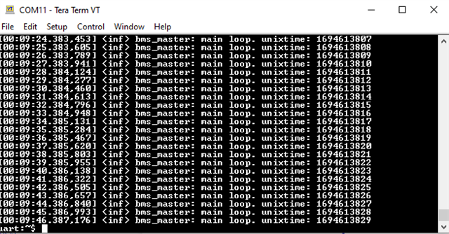

I am having issues separating the LOG_ and Shell on the nrf5340. (I am currently using the DevBoard)
I have created an overlay file to move the shell on UART2, which is connected via an FTDI adapter to my PC.
    chosen {
      zephyr,shell-uart = &uart2;
  &pinctrl {
    uart2_default: uart2_default {
        group1 {
            psels = <NRF_PSEL(UART_TX, 1, 11)>;
        group2 {
            psels = <NRF_PSEL(UART_RX, 1, 12)>;
            bias-pull-up;
    uart2_sleep: uart2_sleep {
        group1 {
            psels = <NRF_PSEL(UART_TX, 1, 11)>,
            low-power-enable;
&uart2 {
    status = "okay";
    current-speed = <115200>;
    pinctrl-0 = <&uart2_default>;
	pinctrl-1 = <&uart2_sleep>;
Modified the prj.conf
# RTT LOGGING
CONFIG_LOG=y
CONFIG_LOG_BACKEND_RTT=y
CONFIG_LOG_BACKEND_UART=n
CONFIG_LOG_MODE_DEFERRED=y
Added the Shell
# SHELL
CONFIG_SHELL=y
CONFIG_SHELL_MINIMAL=y
CONFIG_SHELL_BACKEND_RTT=n
The result is as follows
so basically the LOGs are output in both backends. Any thoughts?

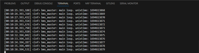

  • Replying to myself as I have spent some time looking for the issue. I was missing
    ##  Disables log output to all shell backends
    CONFIG_SHELL_LOG_BACKEND=n
    Once that is added to the project configuration the LOG_ is just in the log console and the shell is being output via RTT.
