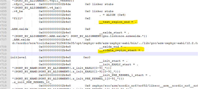

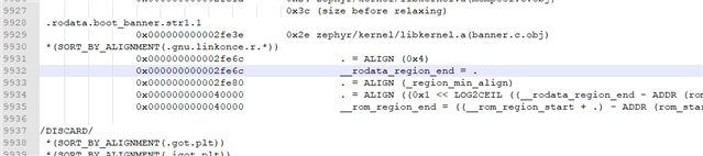

I'm developing my firmware integrating the Matter light bulb sample and while the sdk 2.4.2 overflowed the text region the new 2.5.0 reduced the Matter size so it fits now. But I'm now getting section `rodata' will not fit in region `FLASH', region `FLASH' overflowed by 18780 bytes and whatever parameter reduction or optimization I do that number of bytes never changes.
