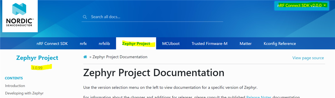

  • Hi Torbjørn,
    I tried to go both ways a bit and played around with excluding app_timer.c or app_timer_freertos.c from build, commenting out the duplicate function in one of the two or adding the missing functions from app_timer.c in app_timer_freertos.c (e.g. app_timer_cnt_get). This worked in the sense of the build compiling and I was able to flash it on the MCU, but then either the MCU just didn't work at all (LEDs not blinking the way they should be, no output in serial, ...) or the timer functionality just didn't work and the counter of the ticks elapsed since startup was stuck at 0. I tried around with the solutions in this  APP_TIMER_KEEPS_RTC_ACTIVE SDK15.0 rtc does not start unless at least 1(one) timer is active post, but it didn't work for me.
    My guess is the whole example code is just too much coupled to freeRTOS for the app_timer functionality to work, but it's just an uninformed guess.
    I then gave the repo with zephyr based examples a shot and installed the latest version of nRF Connect SDK vor Visual Studio.
    I had to do some fixing, specifically:
    - comment out LOG_PRINTK_MAX_STRING_LENGTH, LOG_DETECT_MISSED_STRDUP, LOG_STRDUP_MAX_STRING, LOG_STRDUP_BUF_COUNT in the prj.conf file.
    - change #include <zephyr.h> to #include <zephyr/kernel.h> for the whole repo
    - add zephyr/ in before header file includes of sys/printk.h, logging/log.h, device.h, drivers/gpio.h, drivers/spi.h for the whole repo
    This fixed a lot of build errors, but in the end I am still having build errors where I am not sure how to fix them (see below). The repo is not purely nRF Connect SDK based, but zephyr based and uses zephyr 2.7. From the error message during the build process I take that the zephyr version in my nRF Connect SDK is 3.4.99.
    Is there a possibilty to downgrade the zephyr version that the nRF Connect SDK uses?
    I will also make a post on the qorvo forum about this and see if anyone there has example code for the newest nRF Connect SDK. If it doesn't get an official answer by qorvo/decawave I might try my luck with the support. I will link the post here when I created it.
    Timo

  • Hi Timo
    Different NCS versions will use different Zephyr versions. If you open the documentation here you can find the relation between the NCS version and the Zephyr version by selecting the NCS version you are interested in top right and seeing which Zephyr version it includes, as shown here:
    It seems I have to go back to NCS v1.8.0 to find one that uses Zephyr v2.7.0, which is a pretty old version.
    Possibly the code will build in newer versions of NCS/Zephyr as well, but this hasn't been tested any you might run into build or runtime errors.
