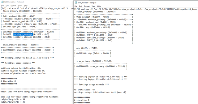

    While you don't have CONFIG_NVS=y enabled, you can see from the partition report that the settings_storage partition is not created, which results in the initialization error
    Adding CONFIG_NVS=y the settings storage partition will be added to the partitioning

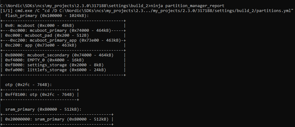

  • You are absolutely correct, the config is already present in the configuration you provided. Wow, that's interesting. It is however not present in a pristine version of the settings subsystem sample for NCS v2.3.0
    What I did was to take a pristine settings subsystem sample, which has the configuration like this
    CONFIG_STDOUT_CONSOLE=y
    CONFIG_FLASH=y
    CONFIG_FLASH_PAGE_LAYOUT=y
    CONFIG_FLASH_MAP=y
    CONFIG_SETTINGS=y
    CONFIG_SETTINGS_RUNTIME=y
    Then I added
    ############### Added Configs ################
    CONFIG_BOOTLOADER_MCUBOOT=y
    CONFIG_FILE_SYSTEM=y
    CONFIG_FILE_SYSTEM_LITTLEFS=y
    which resulted in  the following result for the 52840DK (nrf52840dk_nrf52840) and the 5340DK (nrf5340dk_nrf5340_cpuapp)
    After that I added CONFIG_NVS=y to the bottom of the prj.conf
    which added the settings_storage partition to the partitioning as well as successfully initialized the settings subsys (from the device terminal output)
    So I find it interesting that this does not work on your end
    1. Have you made any other modifications to the project?
    2. Which build target did you build for?
    3. What revision is the 5340DK you have available?
    4. Could you check the partition map for the modified to see if settings_storage is located there?

  • Another developer on the project was having similar flash issues and found he could create a pm_static.yml partition file. He also added the settings subsystem mapping as well. This appears to have resolved the issue although admittedly I still don't why the auto gen'd partition.yml didn't work.
