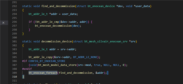

If you want to decommission all switches you can use bt_enocean_foreach().
Answer 2)
EnOcean switches can be decommissioned individually using bt_enocean_decommission().
I tried to delete all registered EnOcean switches based on the answer above, but I was unable to delete them.
I'm guessing that the method of specifying the arguments is probably wrong, but even when I look at the reference, I can't find any specific code, so I'm having a hard time.
I searched the internet but couldn't find any useful information.
question)
Please tell me how to delete all commissioned EnOcean switches.
It would be helpful if you could tell me with sample code.
Thank you.
    I would suggest to continue the ticket 316077 with Terje. We should avoid creating multiple questions of the same topic.
    Please try to get familiar with bt_enocean_decommission() function and check that you can decommission one device at a time.
    The effect of calling bt_enocean_foreach() is to loop through each of the enocean device in the database. For example if you do bt_enocean_foreach(my_function, NULL) then you will have a call to your "my_function() " function on each of the enocean device. In your my_function() you can decommision the device by calling bt_enocean_decommission().
    Please see how it's implemented in \nrf\subsys\bluetooth\mesh\vnd\silvair_enocean_srv.c

  • Hi 輝隆,
    If you followed our suggestion and it didn't work, shouldn't you give us more information about how you implemented it and describe what didn't work ?
    Attached you will find the modified enocean sample (NCS v2.5.0) with a small change to add a decommision button that will decommision all Enocean nodes. I only have one Enocean to test but it should work for multiple nodes.
    This has been added:
    static void find_and_decommission(struct bt_enocean_device *dev, void *user_data)
    		bt_enocean_decommission(dev);
    static void button_changed(uint32_t button_state, uint32_t has_changed)
    	uint32_t buttons = button_state & has_changed;
    	int err = 0;
    		if (buttons & DK_BTN1_MSK) {
    		printk("button pressed ");
    		bt_enocean_foreach(find_and_decommission, NULL);
    When you press button 1 on the DK you will see this:

    In conclusion, I was able to successfully decommission the EnOcean switch just by editing "main.c".
    Therefore, editing "enocean.c" is no longer necessary.
    There was no problem with the following description given in the previous answer.
    ■Delete all EnOcean switches (described in main.c)
    As a result of analysis, the cause of the failure was not the decommissioning of the EnOcean switch, but the button interrupt processing.
    The button interrupt processing was based on the code of a sample program called "button", but that seems to have been the problem.
    By changing the interrupt processing to the code shown below in the sample code, I was able to get it to work without any problems.
