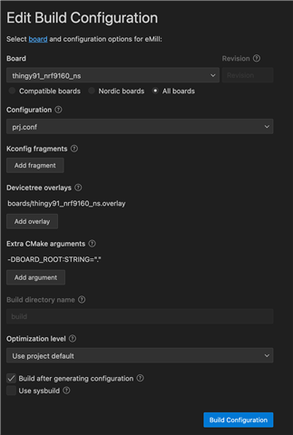

I recently tried the new 2.5.0 SDK and toolchain on my Intel-based Mac running macOS Monterey. The machine is a fresh setup with only the 2.5.0 SDK and toolchain installed – no prior versions.
Initially, I was able to build the Asset Tracker v2 application successfully with the standard settings. However, trouble began when I introduced a debug overlay to my build process. Despite following the documentation, the build fails with linker errors pointing to undefined references.

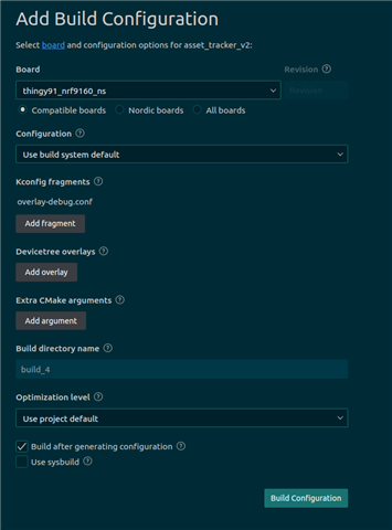

It did build using these settings:
But then it failed when I tried to add the debug overlay:
Here are the steps I took:
  1. Cloned a fresh copy of the asset tracker v2 application.
  2. Successfully built the application using the default configuration.
  3. Added the debug overlay to the build.
  4. Triggered a rebuild.
Unfortunately, this results in the following error:

    My apologies for the late reply.
    Did your build configuration look like this?
    If you manually select "prj.conf" from the "Configuration" drop-down menu and additionally specify a Kconfig fragment, it seems that VSCode overrides the .conf files loaded from the board, which will affect the overall build. This is an issue that we are working on fixing internally.
    Could you try a configuration similar to my above build and see if that works better?
    Håkon
