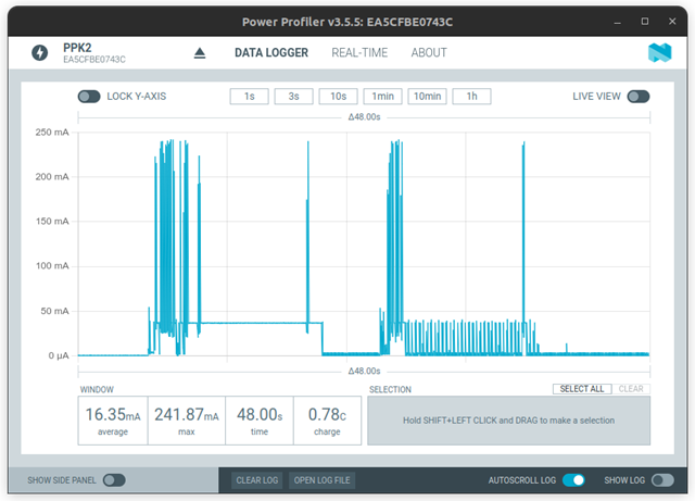

DRX seems not working sometimes
Please see below PPK capture.
I 'm testing with 9160DK, MoSH, LTE-M, and PSM enabled.
There are two "sock send -i  0 -l 500" in the capture, the first one take high power consumption (no DRX waveform).
I did not change and settings between them, and acturally, it happens oftern and randomly.
I wonder it's could be measurement issue? or there are something wrong between modem & carrier?
(modem track attached)
