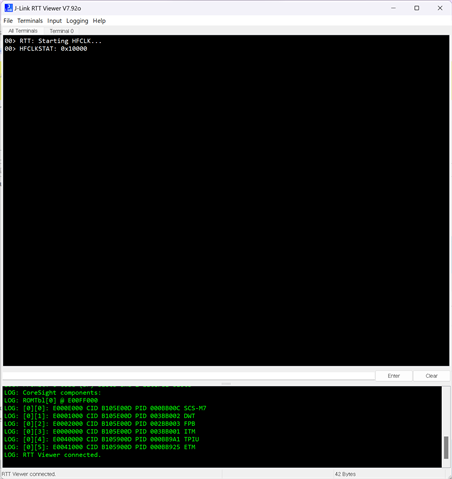

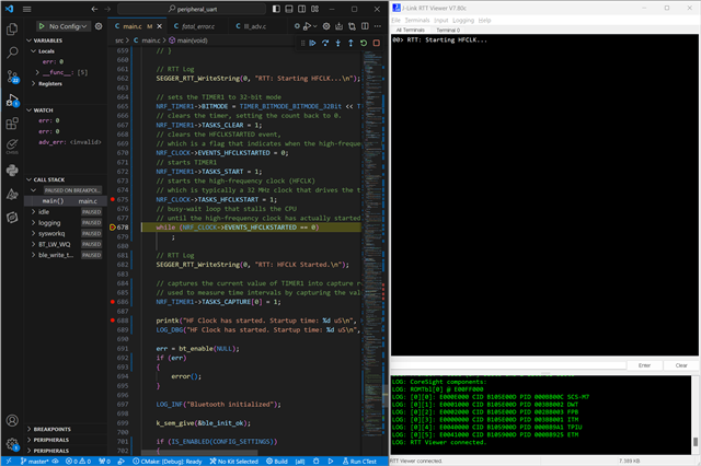

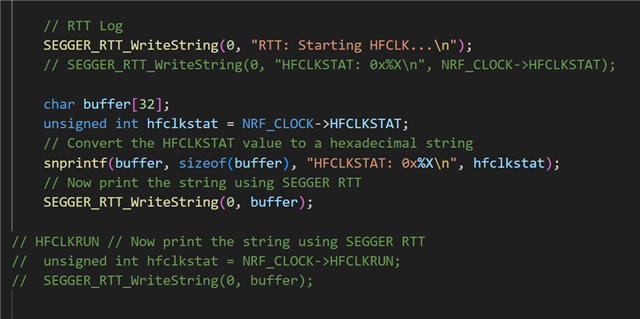

I made my custom board using nrf52832.
Since this will be used for peripheral, I created a new project using custom board wizard in VSCode (nRF Connect SDK) and peripheral_uart sample code.

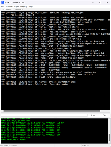

One issue I am struggling is that my firmware keeps throwing fatal exception after bt_le_adv_start() called. (Not right after but inside for loop).
>> err code = 0 (very interesting)
k_sys_fatal_error_handler executed with reason=3
I can't find the device in the connect app. (It's things are right, it should be found)
Here's the current main.c and myboard_defconfig file.

  • Oh. Currently, I didn't soldered UART to USB converter on PCB.
    I thought this won't affect the firmware behavior.
    How do you think

  • Please check below.
    I got to understand why you keep suggesting using RTT log.
    As soon as fatal exception triggered, RTT Log printed on the console.
    Can you guess what's wrong?
