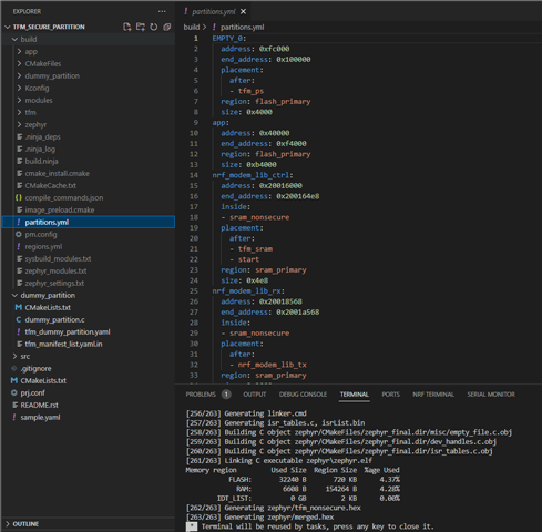

pm_static.yml:
EMPTY_0:
  address: 0xf0000
  end_address: 0x100000
  region: flash_primary
app:
  address: 0x50000
  end_address: 0x80000
mcuboot:
  address: 0x0
  placement:
    before:
    - mcuboot_primary
mcuboot_pad:
  address: 0x10000
  end_address: 0x10200
  placement:
    align:
      start: 0x8000
    before:
    - mcuboot_primary_app
mcuboot_primary:
  address: 0x10000
  orig_span: &id001
  - app
  - mcuboot_pad
  - tfm
  sharers: 0x1
  span: *id001
mcuboot_primary_app:
  address: 0x10200
  orig_span: &id002
  - app
  - tfm
  span: *id002
mcuboot_secondary:
  address: 0x80000
  end_address: 0xf0000
  placement:
    after:
    - mcuboot_primary
    align:
      start: 0x8000
  share_size:
  - mcuboot_primary
tfm:
  address: 0x10200
  end_address: 0x50000
  inside:
  placement:
    before:
    - app
tfm_nonsecure:
  address: 0x50000
  orig_span: &id007
  - app
  span: *id007
tfm_secure:
  address: 0x10000
  orig_span: &id008
  - mcuboot_pad
  - tfm
  span: *id008

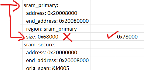

  • Well, I got it to find an image when I modified the `pm_static.yml` to look like what is below. And then updated the boards devicetree file to look like below. But now I am in a bootloop. So I'm not sure I am actually better off and some insight on what I might be doing wrong would be appreciated.
    updated pm_static.yml:
    storage_partition:
      address: 0xf0000
    app:
      address: 0x50000
    mcuboot:
      address: 0x0
      placement:
        before:
        - mcuboot_primary
    mcuboot_pad:
      address: 0x10000
      placement:
        align:
          start: 0x8000
        before:
    mcuboot_primary:
      address: 0x10000
      orig_span: &id001
      - app
      - mcuboot_pad
      - tfm
      sharers: 0x1
      span: *id001
      address: 0x10200
      orig_span: &id002
      - app
      - tfm
      span: *id002
    mcuboot_secondary:
      address: 0x80000
      placement:
        after:
        - mcuboot_primary
        align:
          start: 0x8000
      share_size:
      - mcuboot_primary
    tfm:
      address: 0x10200
      inside:
      placement:
        before:
        - app
    tfm_nonsecure:
      address: 0x50000
      orig_span: &id007
      - app
      span: *id007
    tfm_secure:
      address: 0x10000
      orig_span: &id008
      - mcuboot_pad
      - tfm
      span: *id008
    sram_nonsecure:
      address: 0x20008000
      end_address: 0x20080000
      orig_span: &id004
      - sram_primary
      region: sram_primary
      span: *id004
    sram_primary:
      address: 0x20008000
    sram_secure:
      address: 0x20000000
      end_address: 0x20008000
      orig_span: &id005
      - tfm_sram
      span: *id005

    From your description and the update, it looks like there are issues or inconsistencies in the PM Static Yml file.
    As such, I would recommend if you remove static partition file, and then build the project such that it automatically generates the 'partitions.yml' in the build folder, and then see and modify as per your requirements.
    This will also allow you to track changes that are erroneous, and would provide a starting point.
    In the below image, I have just compiled the 'TFM_SECURE_PARTITION' project for 9160DK, and can see the 'partitions.yml' file in the build folder.
    You just described how I arrived at this particular pm_static.yml file that I have posted. Between looking at generated partition.yml files for examples and reading various posts on this site, I have tried to remake this a few times now. If there are issues or inconsistencies in the static partitions then I'm asking if someone can take a look at it to see what those might be because I clearly am not seeing them.
    To be clear, I can also compile examples for dev boards and run them on a dev board, but it's not translating to my custom board running the nRF9160 and I am not seeing why. So if you see something in my pm_static.yml file that seems odd or out of place, please let me know as it would be greatly appreciated.
    I don't see any other issue except that one of the size (number) is wrong (snapshot attached below) and that the storage_partition is getting defined two times (in the board file and in the .yml file).
    What I have seen is that if you need to change the storage_partition already defined in the board file, then first they delete it (using delete property in the overlay) and then redefine it.
