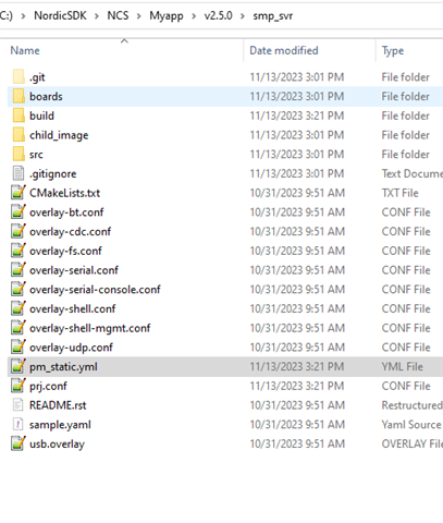

also im getting this error but I do have pm_static.yml in my boards folder:

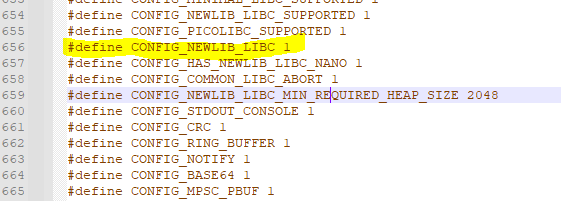

  • Hi Ivan,
    Could you please double check in your autoconfig.h if you have CONFIG_NEWLIB_LIBC_SUPPORTED=y.
    By default this value should be y:
     https://developer.nordicsemi.com/nRF_Connect_SDK/doc/2.5.0/kconfig/index.html#!CONFIG_NEWLIB_LIBC_SUPPORTED

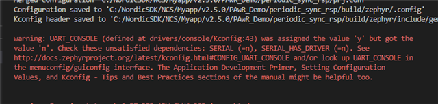

  • CONFIG_NEWLIB_LIBC_SUPPORTED was assigned the value y, but got the value n. Missing dependencies:
    "" = y
     im using nrf5340
  • Please show the actual build log.
    Also please test with smp_svr to check if it builds. If it builds, please compare and check why it doesn't in your case.

    CMake Warning at C:/ncs/v2.5.0/nrf/modules/mcuboot/CMakeLists.txt:320 (message):
    --- WARNING: Using default MCUBoot key, it should not ---
    --- be used for production. ---
    CMake Warning at C:/ncs/v2.5.0/nrf/cmake/partition_manager.cmake:79 (message):
    --- WARNING: Using a bootloader without pm_static.yml. ---
    --- There are cases where a deployed product can consist of ---
    --- multiple images, and only a subset of these images can be ---
    --- upgraded through a firmware update mechanism. In such cases, ---
    --- the upgradable images must have partitions that are static ---
    --- and are matching the partition map used by the bootloader ---
    --- programmed onto the device. ---
