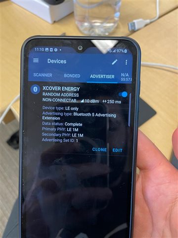

I am trying to use nrf connect to send advertising packets using my mobile phone. I don't care about the content of the packet as I am using the signal for energizing purposes. I wish for the packets to be sent over a long time period at maximum output power.
I have tried the following: I chose the "ADVERTISER" section in the app. and then clicked the switch to the right in order to start transmitting. As indicated in the attached photo, I expected to get packets in output power of 10 dbm and in length of 250ms. However, when I used a spectrum analyzer to validate this, I don't see any packets in that length or power.
What am I doing wrong here?
The device I am using is Samsung Xcover 6 pro

    Normal advertising packets can be up to 31 bytes (with 27 byte payload). With extended advertising you can get more (see this blog post for detail). But that will use secondary advertising channels. And the support for extended advertising differs for different phones.

    When you start advertising you are prompted with a screen with some configurations, including advertising timeout (either select a timeout, or configure it to advertise until explicitly disabled).
    Based on what you wrote initially it seems to me that you don't really need advertising at all, but just want to set up a carrier or similar for some testing? If so a phone does not seem like a suitable tool, and a simpler way would be to take a nRF5x DK of some sort, and use the radio test firmware.
