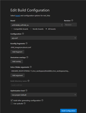

  4. Create a build configuration like this:
  5. Here is also the prj.conf:

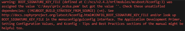

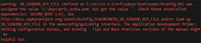

When I compiled the project, I received these warnings:
How can I verify that the bootloader has successfully incorporated the private key into the bootloader image?
What steps can I take to eliminate these warnings?

    In the two first warnings it looks like the location has not been parsed correctly by the build system. Are you certain that the path is "C:\\keys\\priv_ecdsa.pem"? Could you cross examine with the samples in https://github.com/hellesvik-nordic/samples_for_nrf_connect_sdk/tree/main/bootloader_samples/keys_and_signatures (which stores the keys within the project folder)
    The two lasts warnings are not related to the key issue
    Yes, the file exists. Below is the prof:
    After looking at the example, I proceeded in exactly the same way. I added the keys to the project folder. Below you can see the resulting folder structure:
    Add the flags in the CMakeLists.txt as follows:
