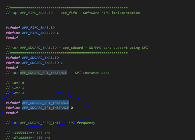

  • Now that I've resolved the original issue with the SPIS example, I want to make SPI0 the slave and setup SPI1 to interact with an SD card peripheral in accord with the "fatfs" example problem. I'm confused as to what settings in the sdk_config file need to be changed to have SPI0 running as a Slave and SPI1 running as a fatfs peripheral. In the fatfs example the config file has NRFX_SPIM_ENABLED 1 (enabled) and NRFX_SPIM0,1 &2_ENABLED 0 (disabled). But it also has NRFX_SPI_ENABLED 1 and NRFX_SPI0,1&2_ENABLED 0. Do I leave NRFX_SPIM_ENABLED 1 and NRFX_SPI_ENABLED 1 and change both NRFX_SPIM1_ENABLED 1 and NRFX_SPI1_ENABLED 1 to make SPI1 the fatfs device? And similarily, what changes are needed in the SPIS config file to make SPI0 the slave?
    Just to be clear, it's only the SPIS peripheral that supports SPI slave. The SPI and SPIM both implements SPI master but the difference is that the latter use EasyDMA.
    The fatfs example use SPIM instance 0, while the SPIS sample use SPIS1. To merge the examples you should start with diff the two sdk_config.h files. You can use VS Code for that. You'll then see what you need to add for the all of the correct configs to be enabled.
    In short to enable SPIS1 in the config you need to add:
    NRFX_SPIS_ENABLED 1
    SPIS_ENABLED 1
    SPIS1_ENABLED 1
    You also need to add the other SPIS related configs such as IRQ priority and DEFAULT_DEF. Again, if you diff the files then it would be clear what you need to add,

    I'd like to be certain about which SPI peripheral is being used for which process. Given the combined sdk_config.h file below, is the SPIM and SPI, for the fatfs portion, running on SPI0 and is the SPIS running on SPI1? If I wanted the fatfs portion to run on SPI2, what would have to be changed? And if instead I wanted the SPIS to run on SPI2, what would the changes be?

    This definition of the sdk_config.h file decides which SPI instance that is used for the APP_SDCARD that is used in the fatfs example:
    You need to set APP_SDCARD_SPI_INSTANCE to 2 and enable SPI2 by setting:
    // <e> SPI2_ENABLED - Enable SPI2 instance
    #ifndef SPI2_ENABLED
    #define SPI2_ENABLED 1
    // <q> SPI2_USE_EASY_DMA  - Use EasyDMA
    #ifndef SPI2_USE_EASY_DMA
    #define SPI2_USE_EASY_DMA 1
    and:
    NRFX_SPIS_ENABLED 1
    SPIS_ENABLED 1
    SPIS2_ENABLED 1
