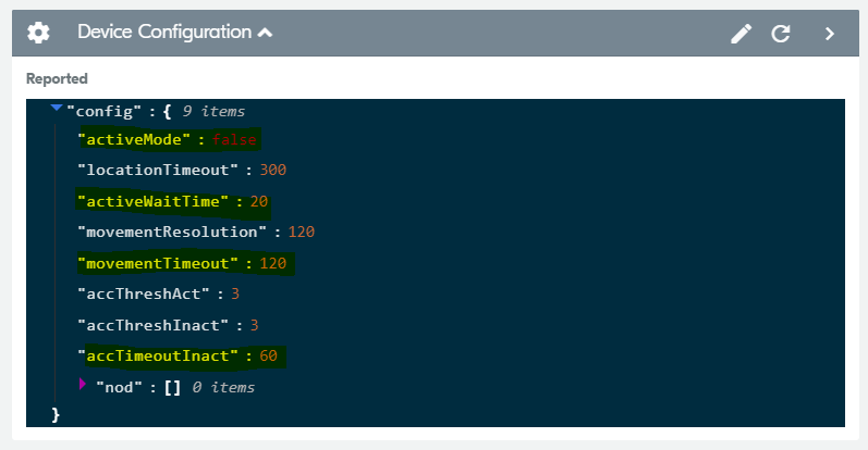

I am using the Asset TrackerV2 example on a v1.6.0 Thingy:91 SDK v2.4.2 with updated connectivity_bridge and latest Modem Firmware (2023-06-01).
My goal is to send data every 20s while the device is 'active'. When the accelerometer doesn't detect 'movement' for 60s the device should go to 'pasive (sleep)' mode and sends out data every 120s.
In order to achieve this i used the following settings:
The device sends updates every 120s while it stand on the table as intended.
However, i am unable to get the device into the 'active' mode, even while shaking the device. I played with the accThreshold in/act values, but without succes.
Any tips/ideas?
