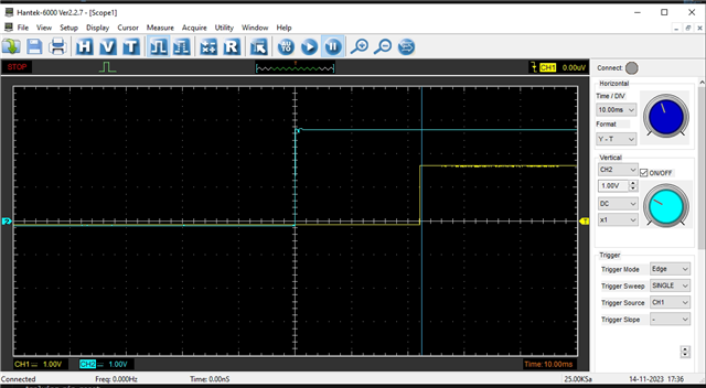

Hello.
My name is Stephen and I am developing a beacon device using nRF52840 and Zephyr. I am using ncs 2.4.2. I need to optimize the boot-up time. I triggered the GPIO pin in the first line of the main function and measure time interval after VDD is triggered. At then, the boot up is 21.7ms. I need to reduce the boot-time less 10ms. To disable the log, I used the following proj.conf.

But the boot-time was not updated.  I'd appreciate it if anyone can help me to solve this issue. I attached the screenshot of boot-up time.

    I would likely have commented out that i2c sensor and see if that have any impact. In any case, I think you should not only look at the time it takes, but also the current consumption during the period. Do you have access to a nordic power profiler kit II so you can measure the entire boot with current consumption? It's also possible to measure digital pins at the same time, so you can see for instance the button press, pin toggling when application start and even i2c if you like.
    Kenneth
