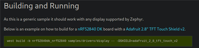

    Which command did you use to build the sample?
    Sigurd Hellesvik
  • I have tried both but still getting the same error:
    Building lvgl
    C:\Windows\system32\cmd.exe /d /s /c "west build --build-dir d:/nrf/test_proj/test/lvgl/build d:/nrf/test_proj/test/lvgl"
    Building lvgl
    C:\Windows\system32\cmd.exe /d /s /c "west build --build-dir d:/nrf/test_proj/test/lvgl/build d:/nrf/test_proj/test/lvgl --pristine --board nrf52840dk_nrf52840 --no-sysbuild -- -DNCS_TOOLCHAIN_VERSION:STRING="NONE" -DBOARD_ROOT:STRING="d:/nrf/test_proj/test/lvgl;d:/nrf/test_proj/test/display;." -DCONF_FILE:STRING="d:/nrf/test_proj/test/lvgl/prj.conf""
    I was also able to see the following message if it is of any use:
    -- Found assembler: C:/ncs/toolchains/c57af46cb7/opt/zephyr-sdk/arm-zephyr-eabi/bin/arm-zephyr-eabi-gcc.exe
    CMake Warning at C:/ncs/v2.5.0-rc2/zephyr/CMakeLists.txt:893 (message):
    No SOURCES given to Zephyr library: drivers__display
    Excluding target from build.
  • Our DKs does not have a display enabled in the devicetree by default.
    If you add a display as a shield to this example, it should build:
  • I have used the following command and I was able to build it successfully.
    C:\Windows\system32\cmd.exe /d /s /c "west build --build-dir d:/nrf/test_proj/test/lvgl/build d:/nrf/test_proj/test/lvgl --pristine --board nrf52840dk_nrf52840 -- -DSHIELD=adafruit_2_8_tft_touch_v2"
    Thanks a lot for the guidance.

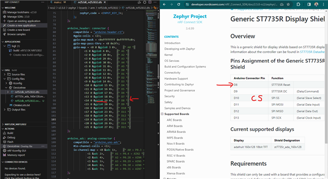

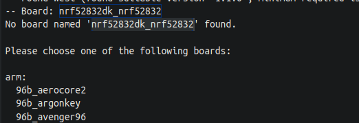

  •   Now I want to build it for nrf52832 but I am getting the following error:
    Command:
    C:\Windows\system32\cmd.exe /d /s /c "west build --build-dir d:/nrf/test_proj/test/lvgl/build d:/nrf/test_proj/test/lvgl --pristine --board nrf52832dk_nrf52832 --
    Error:
      C:/ncs/v2.5.0-rc2/zephyr/cmake/modules/zephyr_default.cmake:129 (include)
      C:/ncs/v2.5.0-rc2/zephyr/share/zephyr-package/cmake/ZephyrConfig.cmake:66 (include)
      C:/ncs/v2.5.0-rc2/zephyr/share/zephyr-package/cmake/ZephyrConfig.cmake:92 (include_boilerplate)
      CMakeLists.txt:5 (find_package)
    FATAL ERROR: command exited with status 1: 'C:\ncs\toolchains\c57af46cb7\opt\bin\cmake.EXE' -DWEST_PYTHON=C:/ncs/toolchains/c57af46cb7/opt/bin/python.exe '-Bd:\nrf\test_proj\test\lvgl\build' -GNinja -DBOARD=nrf52832dk_nrf52832 -DSHIELD=adafruit_2_8_tft_touch_v2 '-Sd:\nrf\test_proj\test\lvgl'
  • Try to delete the build folder.
    Can you send full error log?
  • -- west build: making build dir d:\nrf\test_proj\test\lvgl\build pristine
    -- Application: D:/nrf/test_proj/test/lvgl

    -- Board: nrf52832dk_nrf52832
    No board named 'nrf52832dk_nrf52832' found.
    Please choose one of the following boards:

    CMake Error at C:/ncs/v2.5.0-rc2/zephyr/cmake/modules/boards.cmake:167 (message):
      Invalid BOARD; see above.
    FATAL ERROR: command exited with status 1: 'C:\ncs\toolchains\c57af46cb7\opt\bin\cmake.EXE' -DWEST_PYTHON=C:/ncs/toolchains/c57af46cb7/opt/bin/python.exe '-Bd:\nrf\test_proj\test\lvgl\build' -GNinja -DBOARD=nrf52832dk_nrf52832 '-Sd:\nrf\test_proj\test\lvgl'
    I have also tried nrf52dk_nrf52832 but I was still getting the error. I was using v2.5.0-rc2 version so converted it to v2.5.0 and now it showed a bit progress but I am getting " `RAM' overflowed " error.

  • I was using the wrong command to build. I was trying to build lvgl for adafruit display and I wanted to build it for st7735.
    PS D:\nrf\test_proj\test\lvgl> C:\Windows\system32\cmd.exe /d /s /c "west build --build-dir d:/nrf/test_proj/test/lvgl/build d:/nrf/test_proj/test/lvgl --pristine --board nrf52dk_nrf52832 -- -DSHIELD=adafruit_2_8_tft_touch_v2"
  • Done!
      Thanks a lot for the guidance. It wouldn't be possible to do this task without your help.
    I am sharing the following details so it can help others navigate through this issue:
    1. Build Error:
    I was using the following command to build but I was getting error that nrf52832 is not available board. But the issue was that I was using v2.5.0-rc and I think it was not stable version so I had to shift my version to v2.5.0 and then it worked.
     Command: C:\Windows\system32\cmd.exe /d /s /c "west build --build-dir d:/nrf/test_proj/test/lvgl/build d:/nrf/test_proj/test/lvgl --pristine --board nrf52dk_nrf52832 -- -DSHIELD=st7735r_ada_160x128"

    3. GPIO Issue:
    After building I was unable to identify the pins that should be used to communicate. I tried multiple examples on community but it didn't work. It was only mentioned that you should use D8-D13 (https://developer.nordicsemi.com/nRF_Connect_SDK/doc/2.5.0-rc2/zephyr/boards/shields/st7735r/doc/index.html )but I was not sure where to connect it on nrf52832 development kit. This information was available in "nrf52dk_nrf52832.dts" file as shown in the image attached.
    gpio 19 is refering to P0.19 pin on nrf52832 development kit.
