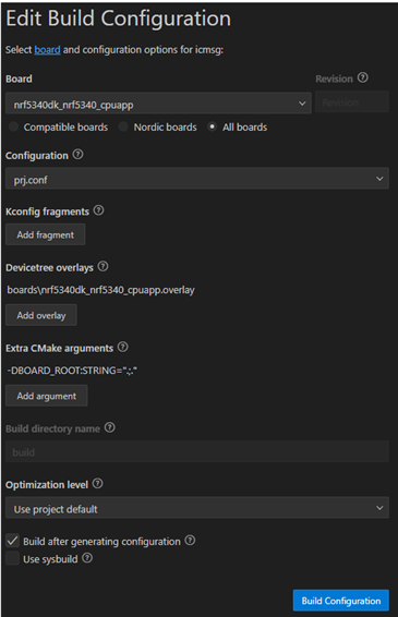

I tried to run the IPC Service-icmsg sample(l\zephyr\samples\subsys\ipc\ipc_service\icmsg) on the nRF5340 DK but failed.
I opened the sample in VS code and created build configuration with default settings as below screenshot. Not selecting 'Use sysbuild', and build succeed, two images were generated. After I flashed to the target, only one log was printed on the application console, and nothing on the network console, please see the screenshot below.
My questions are:
1 without using 'Use sysbuild', the remote image also can be generated and flashed to the network core? this is different from the sample of 'Multicore Hello World application', which use the sysbuild to generate a merged image and flash to two cores.
2 How can I run this IPC Service-icmsg sample on nRF5340 DK? need to set something in somewhere?
BTW, I saw a similar tick and no one answered it in the DevZone(devzone.nordicsemi.com/.../ipc-service-sample-with-icmsg-backend-not-working).
Thank you very much.

  • Hi Raoul,
    Thanks for your reply.
    I realized there is no need for 'sysbuild' in this sample because the project 'remote' was included as an external project in the /icmsg/CMakeLists.txt as below:
    The reason why it cannot run successfully may be that my steps are wrong. I listed my steps below, could you help check it?
    1 Open the sample in the VS Code.
           The sample includes two projects, one is 'icmsg', and another is 'remote' which is located in 'icmsg' as a sub-directory.
           I only need open one VS code to open 'icmsg', no need to open 'icmsg' and 'remote' separately in two VS codes, is it right?

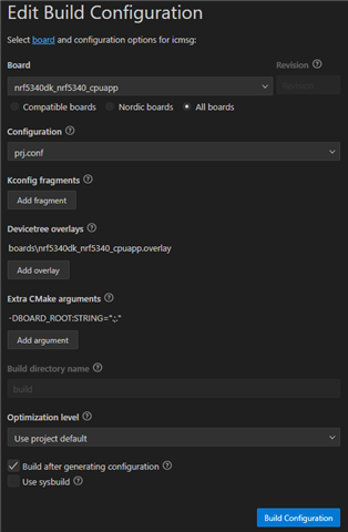

    2 In one VS code, I use the default build configuration as below: (Only one build configuration for 'cpuapp'.)
    3 Start build, I can see both two images for the application core and the network core can be generated.
    4 I use two 'Serail Terminal in nRF Connect for Desktop' to connect the application core with 'COM5', and the network core with 'COM6', but only can see one log on COM5 as described in previously.
    5 Closed the 'Serail Terminal' and used the serial terminals in 'Connected Devices' tab of VS code, the result is the same. Only one log was printed from the application core, but nothing from the network core.

  • I can run the sample successfully now. I'd like to put a summary here:
    1. The project 'icmsg' is for the app-core and has a subdirectory 'remote' for net-core.
    With the default build (without sysbuild) can build two images for two cores. The reason for not using sysbuild and can build two images is that in the CMakeLists.txt, the 'remote' was added as an ExternalProject.
    2. When Flash, in my case, only the app-core image was flashed successfully, we can know this by the 'read' in the tool 'nRF Connect for Desktop'.'Programmer'.
    3. In this situation, I open the 'remote' project separately in the VS code and flash the net-core image separately.
    After that, I can see the traces on the net-core.
