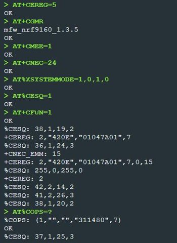

Here is a screenshot showing the AT command network connect sequence sent to the nRF9160DK:
And here is a screenshot showing the same AT command sequence sent to the SparkFun Thing Plus (note the same modem firmware version, and note that the same SIM card was used):
