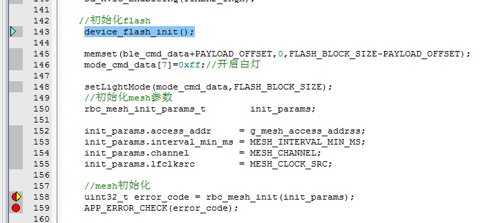

I add my own codes in nRF51-ble-bcast-mesh-sdk-8-support project,
then I find that if device_flash_init() is compile to this project,
the program cannot finish rbc_mesh_init(),
and stop at sd_rand_application_bytes_available_get() in rand_init(void).
image description image description image description
Here is my device_flash_init() function
#define FLASH_BLOCK_SIZE  20
void device_flash_init(void)
      uint8_t *block_list=NULL;
      uint32_t retval,  retval_addrgroup;
      retval = pstorage_init();
     if(retval != NRF_SUCCESS)
     {   nrf_gpio_pin_set(LED_0);
     param_addrgroup.block_size  = FLASH_BLOCK_SIZE;
     param_addrgroup.block_count = 1;
     param_addrgroup.cb          = flash_operation_cb;
     retval_addrgroup = pstorage_register(&param_addrgroup, &handle_addrgroup);
     if(retval_addrgroup !=NRF_SUCCESS)
     pstorage_block_identifier_get(&handle_addrgroup, 0, &block3_addrgroup);
     block_list = malloc(FLASH_BLOCK_SIZE);
     if(block_list!=NULL)
        memset(block_list,0,FLASH_BLOCK_SIZE);
        pstorage_load(block_list, &block3_addrgroup, FLASH_BLOCK_SIZE, 0);
        get_device_addrgroup(block_list);
        free(block_list);
    else
    {block_list=NULL;}
can you one give me some clues? THANK YOU!
  • No,it is not working by now.I just use one sd_ble_enale in my ble_stack_enable function,and delete the other two ,
    then put device_flash_init() between rbc_mesh_init() and nrf_adv_conn_init(),the demo board can
    advertise ,but when I try to connect it using APP , failed with "Timeout interrogating the peripherial"
    and the while(1)-loop stop running
