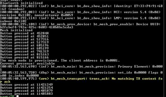

  • Hi Zhong,
    I don't see a problem with that. As long as you don't call any Bluetooth API in the interrupt handler.
    I did a quick test here with the chat sample (NCS v2.5.0) and I didn't see any problem.
    main.c :

    Could you please test ?
    If you plan to call BLE function inside a the handler, you would need to use work queue instead. Or you can use the dk_buttons library like in our peripheral_lbs sample.
