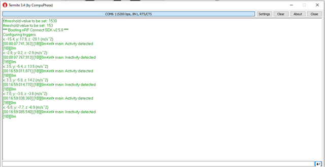

How to configure Trigger for ADXL362 using sensor library
I am studying a little bit about the sensor library. Unfortunately, I haven't been able to find any good documentation about sensor library, what function calls are available for each sensor and etc... Is it available?
Anyways, my current problem is with ADXL362 accelerometer. I am trying to set a trigger (instead of polling data like in accel_polling project available at zephyr\samples\sensor\accel_polling)
I want to only read data when the movement threshold has been triggered.
However, it is not fully clear how can this be achieved and could not find any useful information online about it.
My project repository:
github.com/.../thingy91_motion_trigger
I am currently testing on the Thingy 91 board and running the following code:

After flasing the nRF9160 on the Thingy 91 with the source code shown above, I am getting the following error:
À*** Booting nRF Connect SDK v2.5.0 ***
sensor: device adxl362@0 ready.
[00:00:00.270,568] [1B][1;31m<err> ADXL362: Unsupported sensor trigger[1B][0m
Trigger set error
I would appreciate if someone could help me:
  1. By sharing sensor library documentation (especially what function calls are available for each sensor and how to use them correctly)
  2. Figure out what could be the issue with the code and why I am getting unsupported sensor trigger issue
  • UPDATE:
    After digging through the source code of the ADXL362 driver (zephyr\drivers\sensor\adxl362)
    I have discovered that SENSOR_TRIG_THRESHOLD is not supported.
    See the adxl362_trigger_set function (adxl362_trigger.c):

    So I have modified my code slightly, removed the SENSOR_TRIG_THRESHOLD  and added only those trigger methods that are supported. See my updated main.c below:

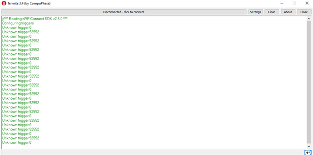

    Once I run the code, the following logs are being printed:
    ð*** Booting nRF Connect SDK v2.5.0 ***
    SENSOR_TRIG_STATIONARY
    I have tried to move the Thingy91 board but nothing is triggered. I believe I am getting closed to figuring out how to properly set this up. I just need to figure out how to trigger SENSOR_TRIG_MOTION and SENSOR_TRIG_DATA_READY. Do I need any additional setup to get it to work?
    Perhaps I am not handling the events in trigger_handler correctly?

  • The data in the Serial Terminal shows that the two triggers are registered immediately one after the other regardless for how long I'm shaking the Thingy (i.e. there is constant sequence of pairs of coordinates (movement+stationary) - stationary is registered even when I'm moving the device);
    This sounds like you have trigger threshold set wrong. Did you do sensor_attr_set to set trigger threshold?
    I'm not sure how to interpret the continuous movement in the context of Zephyr/the sensor driver:
    1. is there a separate trigger to be used (I've seen someone using
      SENSOR_TRIG_DATA_READY in another code sample ...)?
      b. or maybe some kind of loop has to be employed in the specific case?
      c. or another OS related mechanism should be used (an interrupt, or something)?
    You can use accelerometer without any triggers. The sample project is available at zephyr/samples/sensor/accel_polling
    However, for detecting vibrations you could just set trigger thresholds (lets say you want to detect 5G change). You can configure trigger to only activate SENSOR_TRIG_MOTION when the acceleration change detected is larger than 5G.

    Although it is not fully clear to me why the trigger is only available for X axis on the ADXL362. How can I trigger the MOTION event when I am accelerating in Y axis instead of X?
    [00:00:57.210,723] [1B][0m<dbg> main: trigger_handler: Inactivity detected[1B][0m
    x: -0.3, y: -13.7, z: 1.8 (m/s^2)
    [00:00:57.281,250] [1B][0m<dbg> main: trigger_handler: Activity detected[1B][0m
    x: -2.4, y: -12.2, z: 0.5 (m/s^2)
    [00:00:57.290,039] [1B][0m<dbg> main: trigger_handler: Inactivity detected[1B][0m
    x: -0.9, y: -7.1, z: 0.1 (m/s^2)
    [00:00:57.337,005] [1B][0m<dbg> main: trigger_handler: Activity detected[1B][0m
    x: -0.4, y: -6.2, z: -0.7 (m/s^2)
    [00:00:57.363,464] [1B][0m<dbg> main: trigger_handler: Inactivity detected[1B][0m
    x: -1.0, y: -12.6, z: 0.6 (m/s^2)
    [00:00:57.454,528] [1B][0m<dbg> main: trigger_handler: Activity detected[1B][0m
    x: -0.9, y: -12.8, z: 0.5 (m/s^2)
    [00:00:57.457,458] [1B][0m<dbg> main: trigger_handler: Inactivity detected[1B][0m
    x: -1.1, y: -7.3, z: -3.5 (m/s^2)
    [00:00:57.601,562] [1B][0m<dbg> main: trigger_handler: Activity detected[1B][0m
    x: -0.4, y: -7.5, z: -3.0 (m/s^2)
    [00:00:57.610,351] [1B][0m<dbg> main: trigger_handler: Inactivity detected[1B][0m
    x: 0.2, y: -3.1, z: -8.1 (m/s^2)
    [00:00:57.757,202] [1B][0m<dbg> main: trigger_handler: Activity detected[1B][0m
    x: 0.4, y: -3.1, z: -7.8 (m/s^2)
    [00:00:57.760,162] [1B][0m<dbg> main: trigger_handler: Inactivity detected[1B][0m
    x: 0.5, y: -4.6, z: -13.7 (m/s^2)
    [00:00:57.851,196] [1B][0m<dbg> main: trigger_handler: Activity detected[1B][0m
    x: 0.1, y: -1.7, z: -9.8 (m/s^2)
    [00:00:57.859,985] [1B][0m<dbg> main: trigger_handler: Inactivity detected[1B][0m
    I hope to hear back from  regarding this
