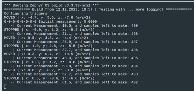

    I see no one still manged to answer your last question. You most probably answered some of it for yourself. I also an on and off trying to understand the concepts here.
    There is something in particular that leaves me wondering.
    While playing with the code (the thresholds for the triggers mostly) I saw that in the output there is always a pair of the two triggers reported - always. There is always MOVED+STOPPED;MOVED+STOPPED;MOVED+STOPPED;MOVED+STOPPED; ...
    They seem inseparable, regardless of the threshold values. My expectation was that if I move the thingy for several seconds I'd have a chain of MOVED;MOVED;MOVED;MOVED;MOVED; ... and then at the end just one STOPPED; trigger reported. Obviously I don't quite understand how the sensor works even though I started to dig in the official datasheet too.
    Anyway, my question is: since your code is an adaptation of the ext_sensors.c (from the Asset Tracker repository), you copied the constants but actually you never used the ones for inactivity (the timeouts - ADXL362_TIMEOUT_MAX_S and ADXL362_TIMEOUT_RESOLUTION_MAX). You also didn't use the ext_sensors_inactivity_timeout_set(double inact_time) function when defining the triggers. And I wonder why - they seem important for the case? Or are they?
    Ivan
  • Hi again ...
    On your question:
    Although it is not fully clear to me why the trigger is only available for X axis on the ADXL362. How can I trigger the MOTION event when I am accelerating in Y axis instead of X?
    I'm stating the obvious (you most probably have seen it ... line 164 in your min.c file) but this just seems o be a limitation in the driver's API. When you try to use the unsupported constant the motion is still registered but for every trigger handling there is an error reported (I think it was -22: EINVAL). And I guess that if the limitation is really tied to the X axis then the easiest "hack" would be to position the Thingy in such a way that the movement happens on its X axis.
    As for the pairs of activity/inactivity that bothered me, I think I figured out what's happening. When motion is detected (the acceleration has passed the upper threshold) at some point the movement starts happening with nearly constant speed. This means that even with the sensor moving the acceleration is practically 0. Hence the inactivity detected.
    I'm not sure if my thinking is correct but I posed the scenario to MS's Copilot and it seemingly "agreed". It even suggested some code for the trigger handler with a flag being raised to maintain the state of movement while it happens but I'm not sure this solves the case with the constant speed.
    I mean, obviously every company that sells smart watches solved the motion detection case and it should be something relatively simple, yet I still can't figure it out. :D
    Cheers!
  • While playing with the code (the thresholds for the triggers mostly) I saw that in the output there is always a pair of the two triggers reported - always. There is always MOVED+STOPPED;MOVED+STOPPED;MOVED+STOPPED;MOVED+STOPPED; .
    When you move the device suddenly, its acceleration goes beyond threshold hence triggering movement event. After that, if its no longer accelerating, it will trigger stopped event (as you have already figuring out in your latest post).
    If you move the device whilst increasing its acceleration (not velocity), then you will never get stopped signal (start by moving the device slowly and increase the acceleration as you move it further).
