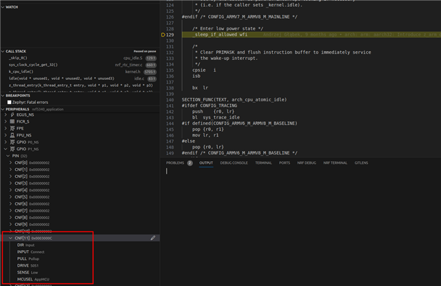

  • hi,thanks for the reply if i set that to flag to flase button interupts were not detected this is how i am doing it

    	nrfx_gpiote_in_config_t const in_config = {
    		.sense = NRF_GPIOTE_POLARITY_LOTOHI,
    		.pull = NRF_GPIO_PIN_PULLUP,
    		.is_watcher = false,
    		.hi_accuracy = false,
    		.skip_gpio_setup = false,
    	/* Initialize input pin to generate event on high to low transition
    	 * (falling edge) and call button_handler()
    	err = nrfx_gpiote_in_init(BUTTON_2_Pin, &in_config, button_handler);
    	if (err != NRFX_SUCCESS)
    		// LOG_ERR("nrfx_gpiote_in_init error: %08x", err);
    		return;
    	nrfx_gpiote_in_event_enable(BUTTON_2_Pin, true);
    regards
