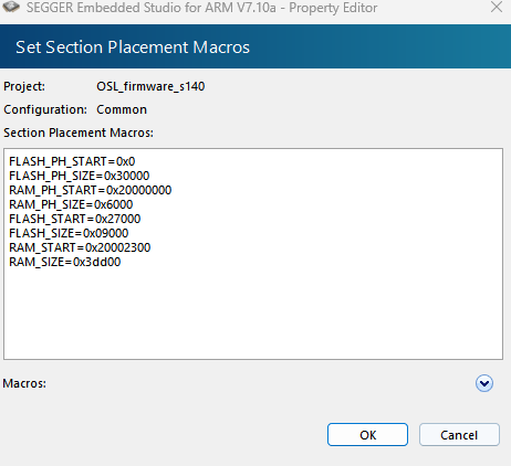

nRF52811 w/ soft device s140
Hi there. In order to up to 20 concurrent onnections to the device, it was necessary for us to switch from the s112 to the s140.
I believe I am messing up the flash placement of this and am not understanding the guides so well.
I was able to discern correctly;
FLASH_PH_START=0x0
FLASH_PH_SIZE=0x30000
RAM_PH_START=0x20000000
RAM_PH_SIZE=0x6000
FLASH_START=0x27000
but the last three I didn't understand how to sort those out.
Not sure if this is related but when I tried to build the project the following error was displayed;
#error "Compiler generates FPU instructions for a device without an FPU (check __FPU_PRESENT)"
Using sdk 17.0.0.2 with SES.
Thanks in advance for any assistance.

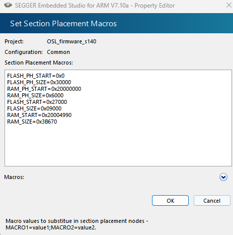

    There is some information here regarding setting the right memory settings when using a SoftDevice. Essentially you have to run the code with your desired configuration, and logging enabled, and you will get a message to the log with instructions what the RAM configuration should be.
    Unfortunately I don't think you will be able to support 20 concurrent connections in the nRF52811. When running multiple connections the RAM usage of the SoftDevice will increase considerably, and the nRF52811 has quite limited RAM available compared to the larger devices in the nRF52 family. Typically you would need something like the nRF52832 or the nRF52833 in order to run applications where you need a large number of links.

    It's impossible to give an accurate answer to that without knowing how much memory you need for your application, but I expect anything above 4 is going to be a challenge.
    To test this you can try to build one of the standard Bluetooth samples, and experiment with the SoftDevice configuration in sdk_config.h.
    I tested this myself based on the ble_app_uart sample, building the one targeting the pca10056 and the S140 SoftDevice.
    When increasing the number of peripheral and total links to 8 I can see in the debugger that the new RAM start location should be 0x20004990, which means the SoftDevice RAM consumption alone is 18.8kB (0x4990 converted to decimal):
    I set the data length and max MTU to minimum values to reduce RAM consumption somewhat. You could also try to use smaller values for the GAP_EVENT_LENGTH parameter, such as 2 or 3.

  • Tried the settings your terminal suggested;

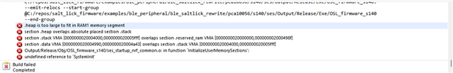

    And got this;
    Hmm I take it's too big then?

  • Hi Kevin
    The RAM_SIZE parameter is surely not correct. The available RAM size equals the total ram size (RAM_PH_SIZE = 0x6000) - 0x4990, which only leaves 0x1670 for the application (or 5.7kB).
    I went through the exercise of updating the ble_app_uart example with project files for the pca10056e board running on the S140 SoftDevice, and I have attached it below:
    317960_ble_app_uart.zip
    Could you take a look at the project in the \317960_ble_app_uart\pca10056e\s140\ses folder and see if you can use it for reference?
    I tried with both 8 and 6 peripherals, but in either case I was not left with enough RAM for the ble_app_uart application libraries. I left it at 4 which seemed to work fine, and I was able to run the application.
    I guess you need to enable more than 4 links in order to justify the move to the S140, but I am not sure how much more is practically achievable.
