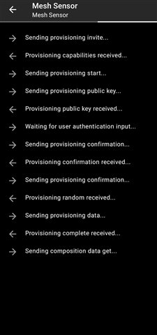

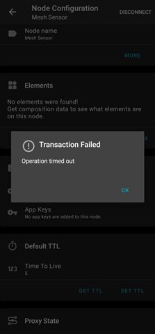

stuck on "sending composition data get"
I'm working with nrf5340 for the BLE mesh Sensor example. It is divided into two parts one is the Sensor server and the other is the Client. I customize the code so it can read various sensors like TDS, turbidity etc. So after building both successfully, I'm facing an error in the provisioning part of the BLE mesh sensor server. The client part is easily provisioned in the right way but when I try to provision the server it gets stuck on "sending composition data get" if I exit the app and then try to get the composite data it again throws an error. both error are attached to the images. I'll also provide the code of BLE mesh sensor server.

I think I messed up with GATT configuration,
  • Hello Omkar23,
    Have you looked at the log of the Sensor Server node to see if there are any clues there?
    If you are new to the nRF Connect SDK, but need to get some quick prototype running, then I recommend the approach where you start from a working sample, and slowly change things in cycles of small changes and tests.
    Hieu
  • Hello Hieu ,
    Thank you for your reply ,
    I see the logs but there is nothing that helps I'll share that too
    It's been 2-3 months since I started working with NCS so I pretty much know about it. even though all things are going smoothly and out of nowhere it stopped provisioning. I also modified the Client code accordingly to my server code so its get compatible with the server but the client is running and provisioning in the right way.
    Also sometimes I'm getting that INITIAL CONFIGURATION FAILED error i thought may be overall is the same error so i refer nrf-mesh-app-initial-configuration-failed but no luck
    I'm not getting any hint or idea what's went wrong here : \
  • Hello Omkar,
    I will wait for the log then. It could be something very simple like a main stack overflow. I have met that in the past and fixed with CONFIG_MAIN_STACK_SIZE.
    I do agree that the log can sometimes be not very useful. However, in this situation, I think it's best to check what we have with it first and then improve the log as needed.
  • Hello Omkar,
