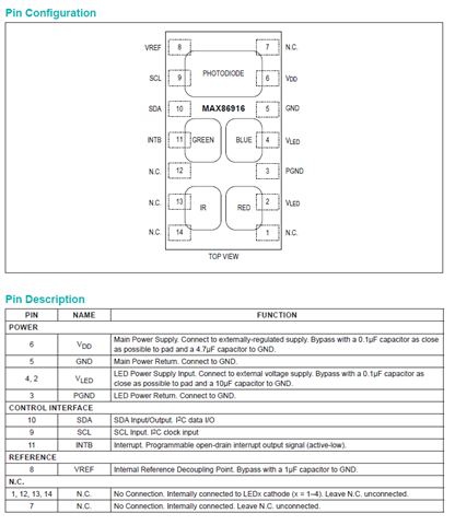

    I read the information provided in the link. as per my custom PCB both sensors are connected on the same pin but their interrupt is at different pins. I checked the PCB and
    1 - Its not possible to make any changes physically to disconnect the pins and connect to other pins
    2 - There is no information for selecting different address

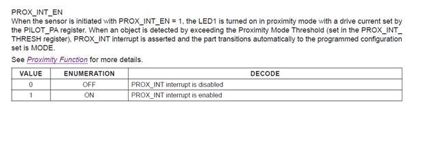

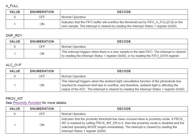

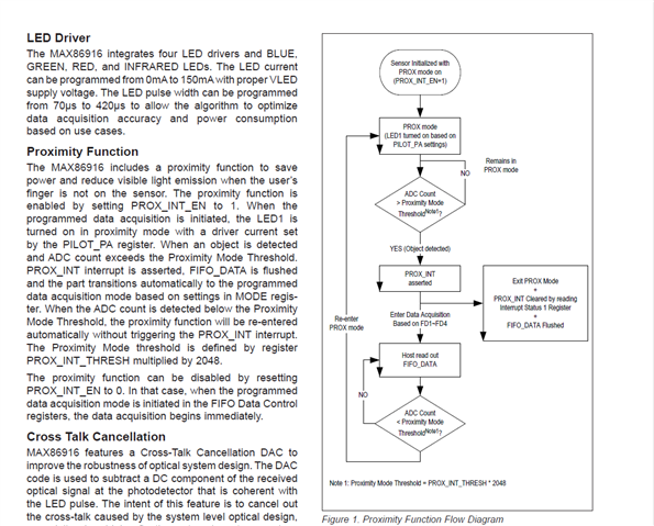

    My Question is... If nothing works then what happened now ?? Means to say as both sensors are connected with same address (The purpose of using two sensors to locate the vein to check the pulse... any of the sensor will find it and give the result). Its mean both sensors will send the data on single address.
    After reading the Data Sheet I came to know that there is proximity option (which means when its enabled, the sensor will start its operation when detects the pulse)
    and
    and
    As per the proximity enable option. Lets assume if any of the sensor (the other will be in the idle mode) find the vein, so I will get the data ?????
    Could look like that. I assume that you have no way to disconnect one of the sensors from power?
    Are the sensors interrupts routed to different pins on the nRF?
    Well, if I2C wakes up the sensor as well, this will not work. I struggle to find if this is the case from the datasheet or not.
