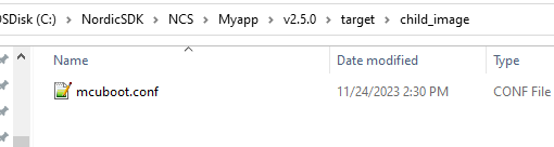

    What you need to do is to add this file in to a child_image folder in your project to enable MCUBoot's serial recovery mode:
    6574.mcuboot.conf
    It should look like this:
    Then you build your application as normal. The reason I suggested this because in the target&distributor, the MCUBoot is already built. You don't need to build MCUBoot separately as in the guide from Zephyr.

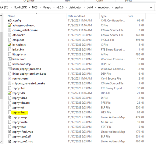

    You can find the file zephyr.hex in the build\mcuboot folder:
    You can use this zephyr.hex in nRF Programmer to upload to the dongle.
    The change in the file I provided above is to allow serial recovery mode. Then you can continue with the instruction in the guide I provided to create the .zip file for the mesh application (build\zephyr\zephyr.hex) then upload it via mcumgr.
