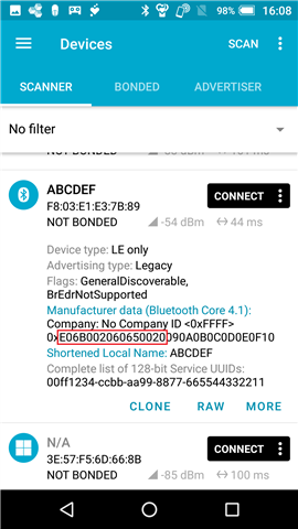

"Manufacturer Specific Data" does not reflect values
SDK: 15.3.0
SoftDevice: S132
Device: EYSHJNZWZ (nRF52832)
I want to use "Manufacturer Specific Data".
I created a sample program, but 8 bytes from the beginning are not set to the value I set.
Please tell me what is the cause.

ble_advdata_manuf_data_t manufacturer_specific_data;
uint8_t manuf_specific_data[16];
memset(&g_advinit, 0, sizeof(g_advinit));
memset(&manufacturer_specific_data, 0, sizeof(manufacturer_specific_data));
g_advinit.advdata.name_type				= BLE_ADVDATA_FULL_NAME;
g_advinit.advdata.include_appearance	= false;
g_advinit.advdata.flags					= BLE_GAP_ADV_FLAGS_LE_ONLY_GENERAL_DISC_MODE;
for(i=0; i<16; i++) {
	manuf_specific_data[i] = (i + 1);
manufacturer_specific_data.company_identifier	= 0xFFFF;
manufacturer_specific_data.data.size			= ( sizeof(manuf_specific_data) / sizeof(manuf_specific_data[0]) );
manufacturer_specific_data.data.p_data			= manuf_specific_data;
g_advinit.advdata.p_manuf_specific_data			= &manufacturer_specific_data;
