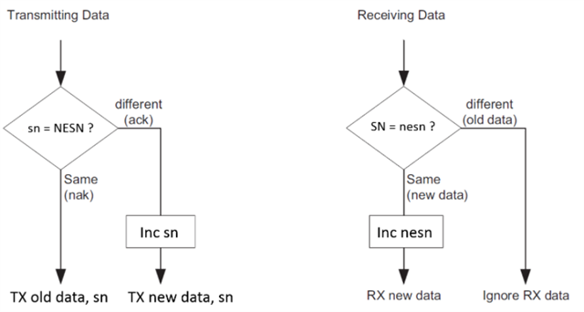

    Additional questions about the material:
    When data sent from the peripheral is not received by the central from the beginning...
    Do you retransmit from the peripheral?
    If the peripheral's transmitted data is not received by the central from the beginning, the algorithm below seems meaningless...
  • Hi ShMoon,
    What do you mean by meaningless ? If the peripheral transmitted data is not received by the central, the central will not increase its sn. The central will try to transmit the same packet again because it's not ACKed.
